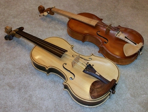

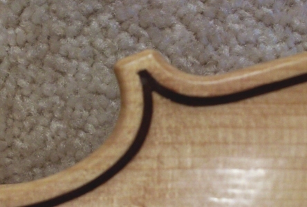

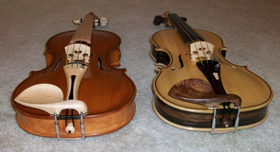

In a previous thread Mark Swanson has suggested that we post more pictures of completed instruments.
I just finished two violins, Number 19 and 20. Built simultaneously.
19: Light Brown
Back, ribs, fingerboard, all fittings: Maple
Top: Spruce/pine/fir??? from a construction 2x10 found in a parking lot
Neck: Maple?? from an old table leg
Purfling: Solid rosewood.
20: Natural color
Back: Maple
Top: same as 19
Neck: Same as 19
Ribs: Ebony
Fingerboard tailpiece, pegs, purfling: Rosewood
Chinrest: ??
Both:
Linings, Blocks, Bass Bar: Spruce from my old piano
Finish: Ace Hardware spar varnish
Strings: Dominants

Beautiful work John. Crisp details.... great colours.

Great work, I really like the contrasts in tone. And the craftsmanship is first-rate.

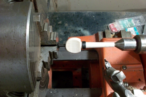

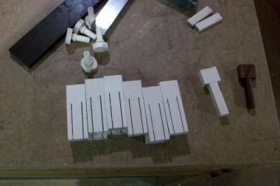

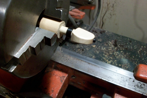

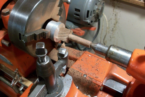

Your work look very nice. I love the originality. How difficult was it to bend the ebony ribs? I'd love to learn to turn pegs since I have a good supply of Dogwood that I think would make great fittings. Do you have any advice on setting up to turn pegs?

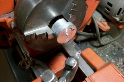

Bending the ebony: This particular piece bent OK using cold bending. On a previous violin, I had bent solid ebony purfling from the same batch. On these last two I bought some new ebony, as I wanted that for the purfling. Nothing I could do got it to bend without breaking, which is why I went with rosewood. From what I've read, that is typical of bending ebony --- some batches do, and some don't.
The pegs: I start with rectangular blanks. While still rectangular I drill a .160" Dia hole in one end, and a small center in the other. I made an aluminum arbor with a matching diameter post, and a socket head screw as a driver. Turn the diameter of the bead and undercut. (On some, I put ebony ring). Turn taper with compound. After all the lathe operations I glue a paper outline of the peg shape. Using a 1" belt sander shape the peg. Then with an oscillating spindle sander I put the concave faces in --- all by hand and eye. Then put chamfer on edges. Turn the .160" insert in the lathe. Use lathe center to align and glue into peg. Turn peg around. Cut and finish insert.
Pictures to follow.

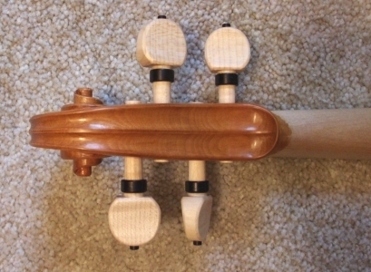

BTW - Great peg work! another thing I've never made.
