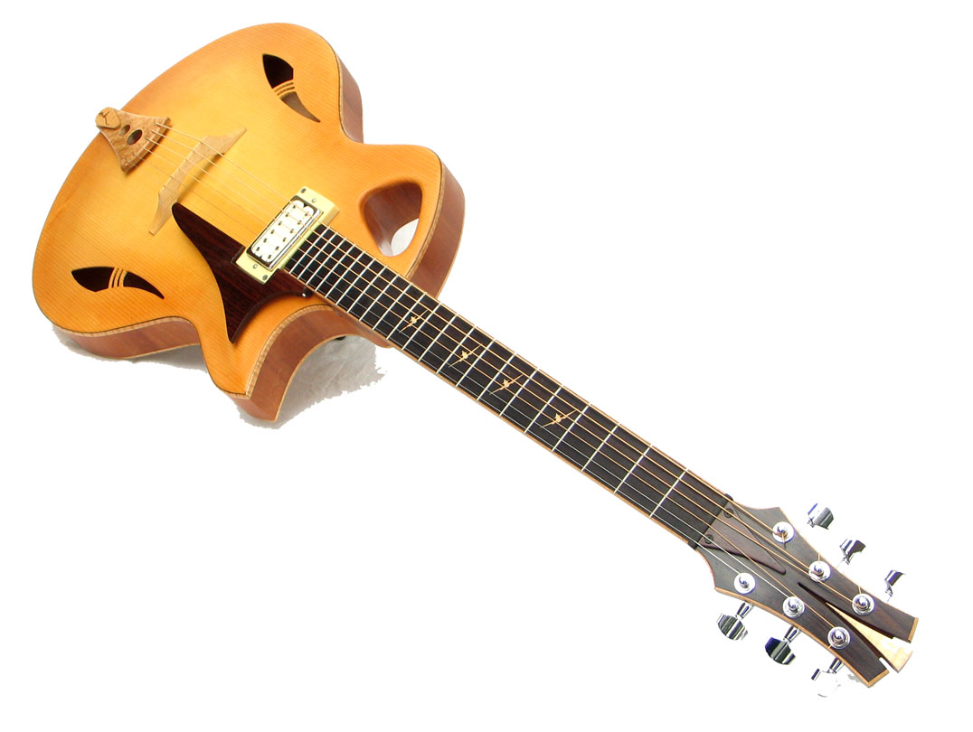

My newest project is just about ready to "fly", just final electronic connection. An hommage to those wonderful WW2 flying machines and my late father-in-law who was the worlds greatest "spit" admirer. The top and back is hand-carved, top German spruce and the back cherry, the sides are bandsaw cut from solid rather than bent okoume wood. It is meant as a hybrid which can be used in acoustic mode, albeit not very loud but much louder than say a 335.
Since this photo, I have made a few subtle changes, a thinner pup ring and a smaller pick guard.
The pup is a pure jazz model by Iconix.

I'll trust your eye on the pickup ring and pick guard, but I'll take her as she is.
Have you always used the disjointed keystone headstock detail? It looks familiar to your style, but I don't remember having looked through it before.
Posts: 1982
Re: "Spitfire" archtop
I think that's very good, Murray. I like it a lot. if I were to change anything, I'd change the bridge and make it a full contact. I think the acoustic tone and sustain would probably benefit if you did that.

I try to change or improve my designs for each guitar, this headstock is a derivation of my "fab4" model.
I found with my previous nylon archtop that bridge design is critical, this is tge first bridge design on this guitar and will try others as we go. Never thought about full contact though, always follow my violin making instincts.

Murray, your headstock looks like something Michio Matsuda would come up with, except yours is symmetrical. Rather eye catching.

The headstock is an effort to introduce some deco detailing ....

Really beautiful. Again some experiments with bridges might be interesting - some archtops sound better with full contact bridges, others with two feet.

I don't, however, understand your finger rest(pickguard). Why is it so narrow nearest the bridge, where it needs to be at its widest? I mean, it looks good, and fits the overall esthetics of the guitar, but its functionality is near zero, no?

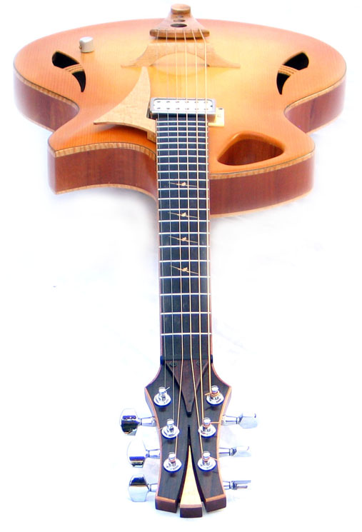

Ah, the pickguard. Well Mario, I have gone even sleeker, see pic :-) Nobody ever buys my guitars and so I design for my own use - and I don't use a pick guard at all.
I've noticed that some players use it as a finger rest and there is more than enough space for a finger to rest on. In this case, it is purely aesthetic (and it even looks nice without it IMO). At one stage I did consider fitting the volume control to the underside but I'm not doing that anymore either.
Thanks for the compliments, this is my penultimate guitar.

What does bother me on many archtop finger rests/pick guards is the apparent lack of forethought of some designers. They go to all the trouble of cutting nice f-holes and even binding them, then go and cover half of the f-hole with a huge pick guard. One of my favourite pick guards is a tiny one on one of the Monteleone archtops .... just a "point".
