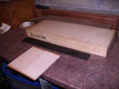

Some of the raw material

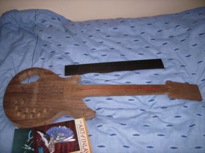

The walnut rough shaped with some of the material removed for weight

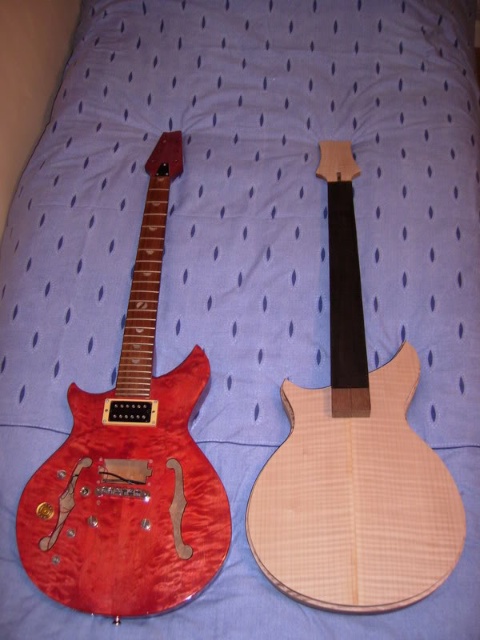

Mock up next to the original for comparison. Top cap is glued and edge is routed to final depth ready for curved top
Mock up with electrics positioned. The controls are attached to a cardboard template and the carve has been started

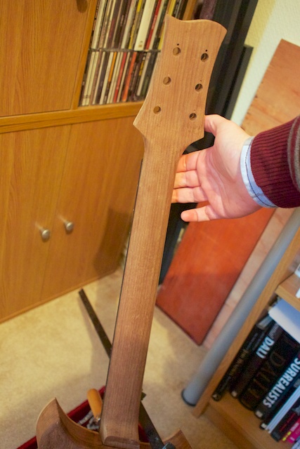

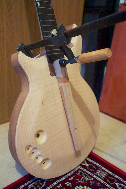

The position so far - The neck is currently glued and is drying. Just the pickup cavities, bridge positioning and final sanding required before I can apply the finish and fittings.

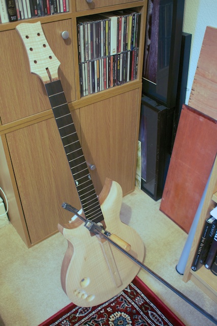

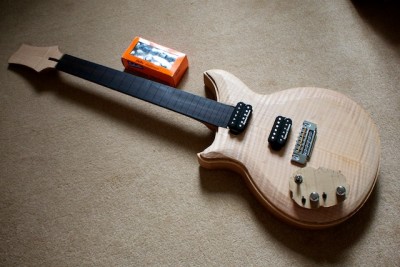

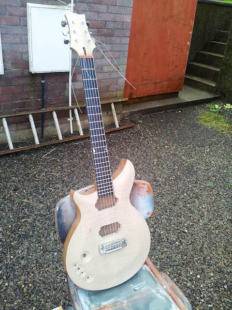

Just for reference sake, here are a few more pictures of the instrument today:

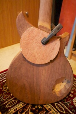

Today saw the pickup cavities routed, but just as everything was going so well the template slipped and now I have fillet just below the neck pickup drying so that I can cut it back and try to hide the damage. It's not too bad - I was able to tell that the router was going off on it's own pretty quickly. That'll be one of those lesson teaching mistakes we were talking about earlier in the thread! I dislike routers.
The upshot to all of this though is that the guitar is now dry strung and all of the woodwork save for the recess for the backplate is done and dusted. I now need to fine sand the body ready for painting and so can begin another round of lessons to learn (hopefully not the hard way!!)

yeah, that's why I stick just a couple of tabs of double sided tape between the template and the work piece even if I'm clamping them!

To be honest Art, it wasn't really the router's fault in this instance - I had good control but my template was poor. despite it being clamped, it came apart at the area just below the bridge pickup. My router is a 1/2" variable speed router with a good level base. I'll chalk this one to experience and go back to the drawing board regarding my pickup templates. I need a nice scroll or jigsaw really so that I can cut one piece templates as I will be with my backplate recess shortly.
