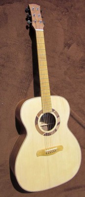

I have built several acoustic guitars with back and sides of Osage Orange. It's one of my favorite woods. I have one with an Osage Orange fingerboard and bridge. It looks quite distinctive. It has been stable since I completed it in the fall and I expect that it will wear better than a rosewood fingerboard.
