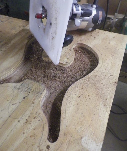

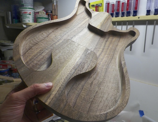

Postby Chad McCormack » Wed Feb 20, 2013 9:21 am
Thanks Louie. The dish carving bit, in my opinion, is the way to go to clean up after all the forstner work on the drill press when chambering. Mine is a 3/4" D Freud bit with a 1/4" cove that gives me a really clean fillet all the way around the boundaries of the chamber.

Postby Adam Savage » Wed Feb 27, 2013 6:51 pm
Chad - a couple of further questions if I may. How thick do you make the sides and the top/back plates? And do you think using a standard pattern-following router cutter (and the corresponding right-angled corner it will produce between the base and the wall) would give too much of a reduction in strength if the wood thickness is around 1/4"?

Re: Chad McCormack's "Equator" Semi-Hollow
Postby Chad McCormack » Wed Feb 27, 2013 8:27 pm
Hi Adam. Side thickness is around 3/8" to 1/2" all the way around except for the obvious spots pictured above, and top and back are a bit less than 1/8", say 3/32". The bit that I use for the chambers is a dish carving bit, which is a top-bearing 3/4" wide bit with a 1/4" radius profile. I use that bit precisely because I don't want a 90 degree angle on the inside with a 1/2" roundover on the outside. If that guitar drops on a corner, I feel like I'm going to have a better chance escaping tragedy with the fillet vs. the square bottom... that, and I just think it's a slicker treatment of the chamber, even if nobody's ever going to look in there :)
