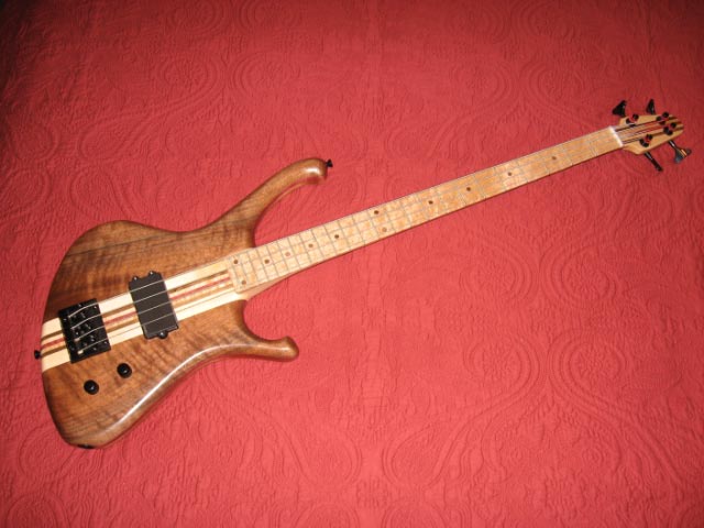

The thru-neck bass I built does not have a neck angle, I built it more like a Fender neck and just had the neck surface high enough above the body. Just make a drawing with the bridge etc. as everyone suggests to work out the dimensions.
