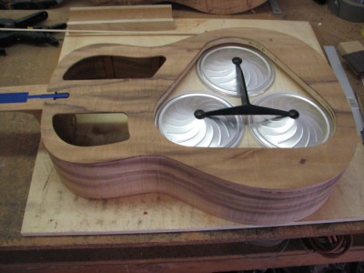

Hi Jeff, I'm currently building a Weissencone too, Just closed the box yesterday.
Had some advice from Freeman too when I started.Thanks Freeman.
Depends on your cones and T bar and cover plate but I ended up with 28mm depth (4mm top plus two layers of 12mm plywood) and it look like that will sit nicely under the cover bar with maybe 4mm saddle above the t bar.
The tricone arrangement was a little tight on my weissenborn outline, I ended up widening the body 7mm at the tail and relieving the corners of the well a bit.

The 28mm deep well has worked out for the weissencone with a 3mm saddle protusion giving me my preferred 8mm string clearance over the board
