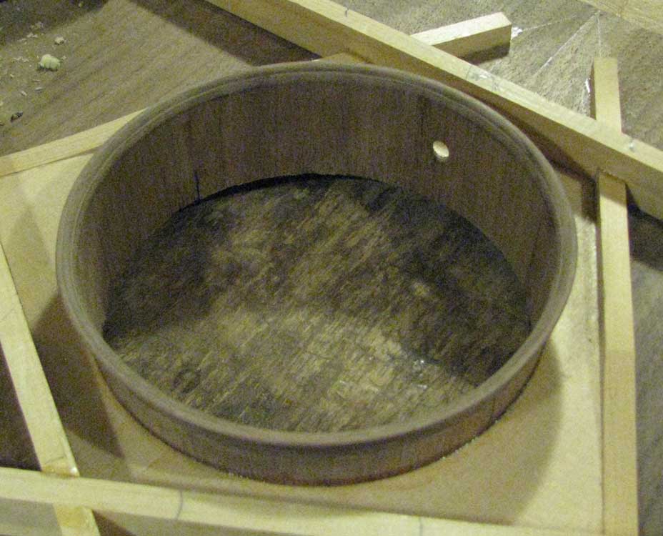

Here is the instrument itself. It was designed as an electro-acoustic, with top transducers, so I didn't need (or want!) to have a string 'main air' resonance that would cause feedback issues. I used my 16" small Jumbo platform, and the walnut top also helps with that.
It's hard to say whether all of my theories worked out exactly the way I'd wanted; there's a lot to sort out on these things. The customer was happy, so it was a success where it counts...
I did want to use a large sound hole, however, to check out an idea I've had about the 'upper cuttoff frequency' of the hole. Basically, that's the point where the hole becomes very efficient at radiating power; a larger hole has a lower UCF. On bass reflex speaker cabs the diameter of the port can be chosen to fill in the mid-range or tweeter frequency, and since the gutiar is basically a bass reflex cab in the low range I thought I'd try to scale that pitch to the tuning range. But alarge hole gives a high 'main air' pitch, and I wanted to keep that down. That's the function of the sleeve: it drops the Helmholtz pitch without affecting the UCF, and also cuts down on the power of the 'main air' mode. Here's a shot of the sleeve being installed on the top.
I made it by wrapping several layers of walnut veneer around a yogurt container, and added a thicker cross-grain rim that could be rounded off to reinforce the edge. I did some experiment on another guitar with cardboard sleeves to get an idea of the right height, and it seems to have worked OK. The hole in the sleeve is for truss rod access. It's hard to say whether all of my theories worked out exactly the way I'd wanted; there's a lot to sort out on these things. The customer was happy, so it was a success where it counts...

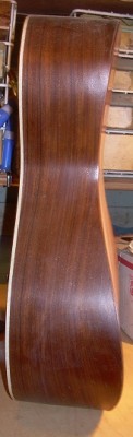

Re: 5 string acoustic bass bass guitar
Here is a guitar design I made a number of years ago. It worked O.K. but had no real benefits over a conventional back shape for a "normal" guitar. I did consider using it for an ABG and actually laminated some back plates for it. I never got around to making the sides and it is still on my "to do" list. It may be one way to increase the depth of the lower bout to 6 or 7 inches to add some cubic inches without making the guitar too cumbersome.
