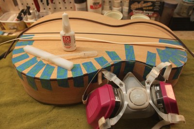

Well never say never. I made try wood again I found that where it turned towards the neck at the upper bout it needed hard pulling at the top edge to get tight to the body. I had to put clamps in various spots to get it tight and it frustrated me a bit. It DID get in there though and does look pretty good. Unfortunately I broke a couple pieces and had to use replacements that didn't have my black white detail that I had planned for at the bottom of the binding so the top binding has the detail and the back binding does not. It's bumming me out a little. I haven't found the willingness to cut it off and do it again. And it was found bloodwood and there's none left, alas.

I had similar problems when I started using wood binding (about 15 yrs ago now). What I learned over time is to fit the binding better to the guitar when I bend it, that makes all the difference. I still bend it on a pipe (I have two fox benders that I don't use - ha).Matt Atkinson wrote:Well never say never. I made try wood again I found that where it turned towards the neck at the upper bout it needed hard pulling at the top edge to get tight to the body. I had to put clamps in various spots to get it tight and it frustrated me a bit. It DID get in there though and does look pretty good. Unfortunately I broke a couple pieces and had to use replacements that didn't have my black white detail that I had planned for at the bottom of the binding so the top binding has the detail and the back binding does not. It's bumming me out a little. I haven't found the willingness to cut it off and do it again. And it was found bloodwood and there's none left, alas.
