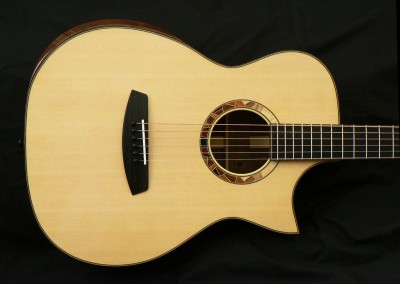

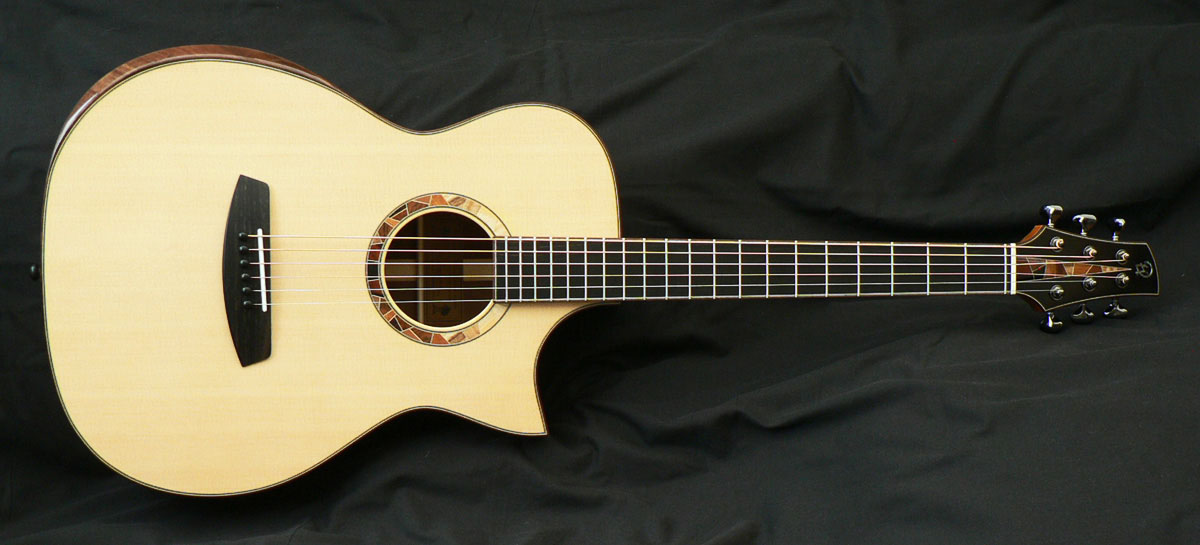

The top is Lutz spruce from Shane Neifer.

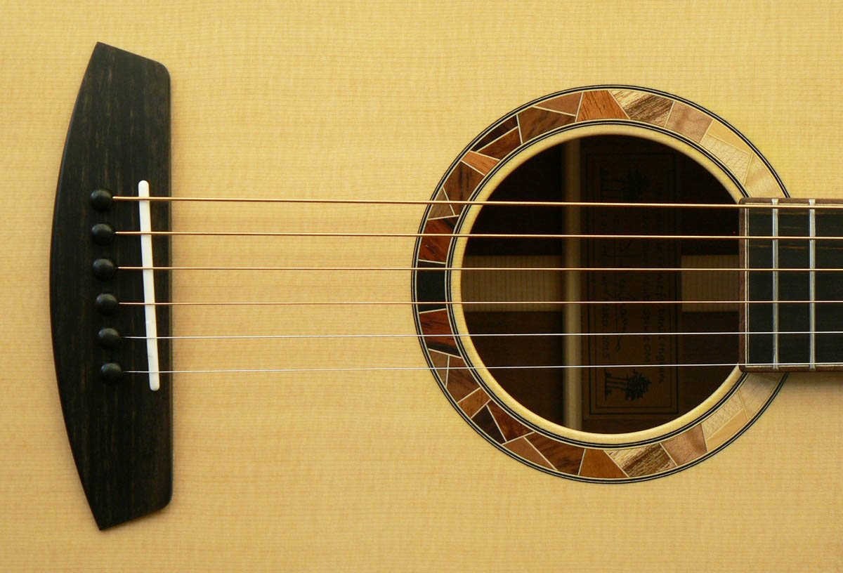

A closer look.
The rosette is a sort of random mosaic of all the different bits of wood I could find. I tried to shade it from dark near the bridge to light at the neck but I think I faded it out a bit too soon.

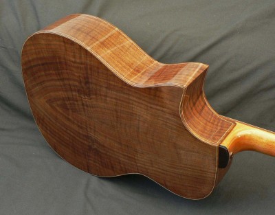

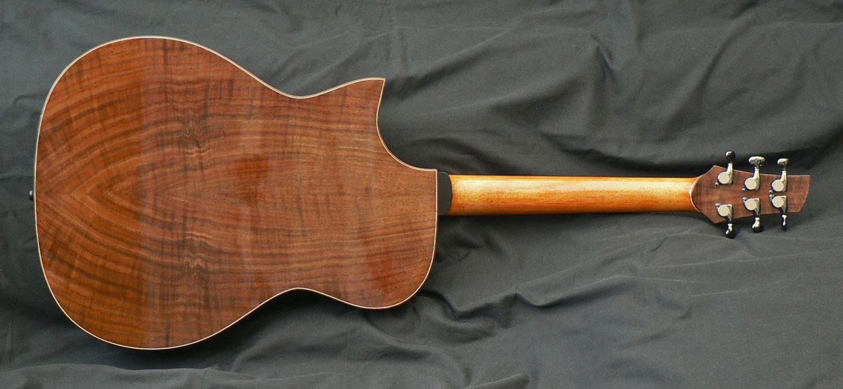

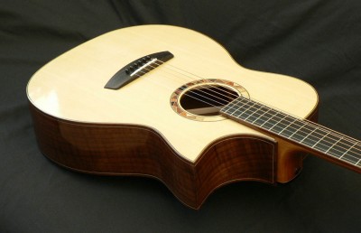

Back view.
When I glued the pointy bit of the cutaway together I luckily got a pretty good join so I decided not to bind that part of it. Thanks to Larry Davis for donating this beautiful set of walnut to the MIMF.

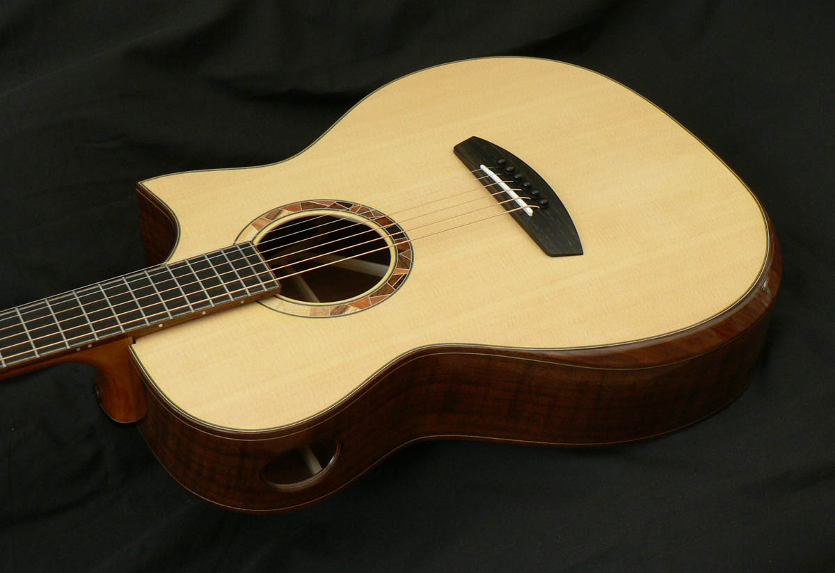

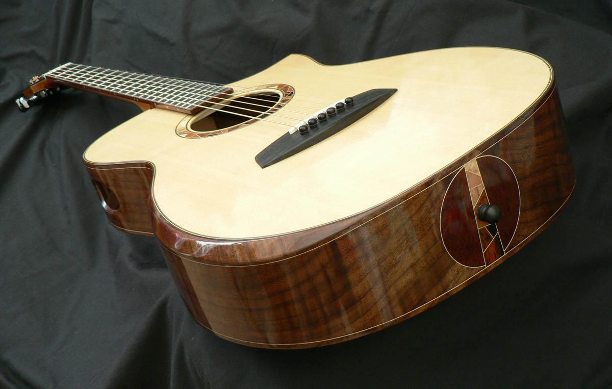

Three-quarter view.
Cutting an elliptical sound-port with a bevelled edge in a curved surface isn’t as easy as I thought. It finished up OK but slightly larger than intended.
I was very apprehensive about the bevel. In fact when I got the box closed I chickened out and bound it normally. Then the aforementioned disaster occurred. We went away for two weeks in February and my humidifier had broken down. I forgot to turn off the heating in the workshop and when we got back there was a 5” crack in the top. I’d already ‘made do’ with one or two things that weren’t as good as they could have been, so I took this as a sign saying “this time do it properly”! So having made a new top I tackled the bevel. I had to join two pieces of off-cuts from the back to make the veneer but it turned out OK thanks to helpful advice from Steve Kinnaird and Fred Tellier.
This view shows the wedge body and the access panel. The end pin is really a screw; it has a piece of threaded rod screwed and glued into it and holds the access panel in place.

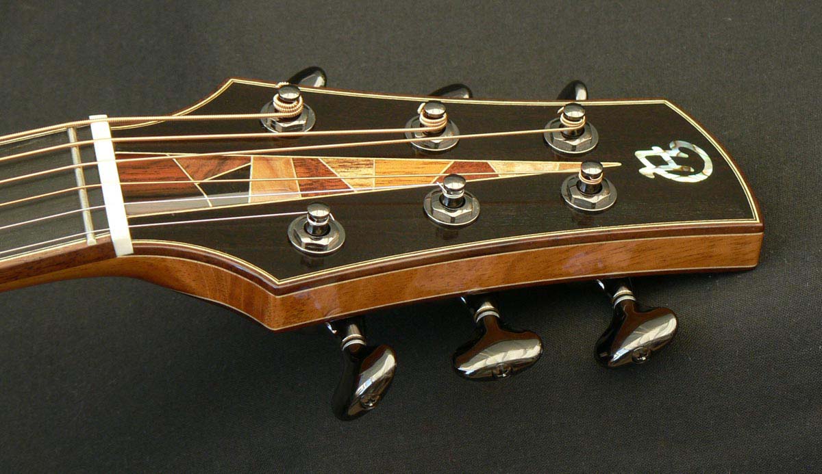

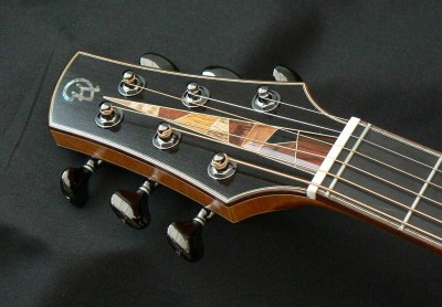

When I’ve done a stacked heel before the joins were quite visible; this time, for some reason they are at lot less visible. The rosewood button covers the head of a socket head screw which holds the neck in place and the action (string height) is adjusted by turning the screw.
If you look carefully you’ll see that part of the headstock inlay is thicker than the rest and has a bevelled edge. That’s the truss rod cover.
Here’s another view of it.
The back-strap veneer is book-matched off-cuts from the back. I like these tuners, but they do add a noticeable amount of weight to the headstock.

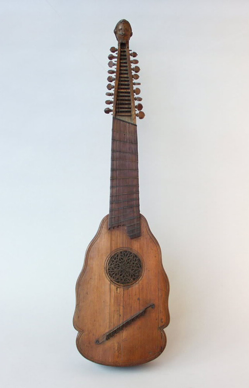

Any chance you could share more info on the fanned fret example above. Really is fascinating to see the concept turn up that long ago.
Is the builder known, and are there by any chance views of the back and sides available anywhere you could refer me to?
Dave Higham
Posts: 97
Re: My first real acoustic guitar in 43 years
Post by Dave Higham »
Thanks Randy, I'm pleased you like it.
The 'fanned fret instrument is an orpharion and you can find much more information on it here:
http://www.cittern.theaterofmusic.com/old/palmer.html
