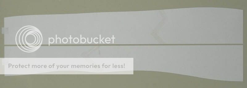

Whet Colin didn't mention in his tutorial is that when the body mould is on the radius dish, you block up the lower bout end of the mould by the difference in body depth between heel block and tail block.
I made an acoustic bass guitar with a wedge shaped body. This meant I had to not only raise the lower bout of the mould, but also tilt the mould sideways to allow for the wedge. The templates worked out perfectly and I didn't have to do any planing of the sides after bending. They were just sanded in the radius dish. This is what they looked like.
