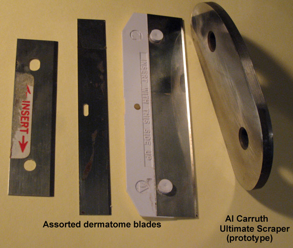

The other thing I've really liked for a final pass for scraping is a blade that is used in a surgical instrument called a dermatome blade. They are used for split thickness skin grafting, and have the sharpest edge I've ever come across. They are very thin and flexible and conform to a radius easily. They are the closest thing to heaven I'll ever get. I have to keep telling myself to barely touch the surface, or it will fold the edge over. It's more caressing the surface than scraping. About 30 passes in one direction turns a slight burr, and then 30-40 the opposite direction turns a burr the other way. I love these things as much as Al's. The problem is I ran across these on a scavenging expedition when a hospital was clearing out old stuff in their warehouse and when I reached the manufacturer to get more, they were 54.00 apiece.
I've been working on trying to get them to sell me the flawed reject blades for two and a half years now, as I just want the edge it has, but every time I get close, someone in the chain gets transfered or has been replaced and I have to start all over.
My thinking is if I could get them for a buck or two apiece for the cosmetic rejects, that I might be able to sell them as a fund raiser for the forum here. I'll continue trying but it's been frustrating so far. Meanwhile I husband them for just the final finish scraping.

Randy, could we have a picture? or part number?

Postby Randy Roberts » Thu Feb 23, 2012 10:49 am
Steve,
Here's a picture of the dermatome blades next to the scraper Al generously shared with me when I visited a few years ago. (I'm not sure it's his final design)

Postby Alan Carruth » Thu Feb 23, 2012 2:37 pm
Tim Douglas asked:
"How large a wheel, Alan?"
Just a normal bench grinder: I don't think the diameter of the wheel matters much, so long as you get the anlge pretty close to right.
That picture of Randy's shows the scraper with the edge not ground. That's the right general size and shape, though.

Dermatome scraper!
I'm not surprised that it's so pricy.
