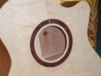

I sliced up a couple sections of Jarrah burl on the bandsaw. Worked great. It was very dry, tho. I just sliced them, and then squeegeed epoxy on the back side to stabilise it all. Sanded it to desired thickness, and then used the epoxy to glue it to the headstock and rosette channel.
Here's the rosette.....
Jarrah burl Rosette
Jarrah burl Rosette
