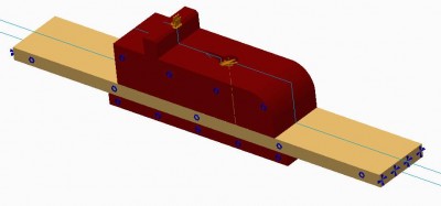

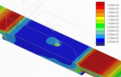

Below are some initial results from a simplified 2.5D FEA model of the bridge, top, and plate. In FEA, it's best to start simple and then add complexity in stages -- that helps understand incremental effects and catch errors. Here's the basic model:
Bridge: 1.5" x .35", integral saddle (no slot), string break angle over saddle = 30 deg.
Top: 0.110" thick.
Bridgeplate: 0.100" x 1.7", extends 0.1" beyond bridge fore and aft.
Pins: Omitted and assumed inactive, as with unslotted pins in a slotted bridge.
Materials: Isotropic elastic, Poisson's ratio = 0.35 for all. Bridge and plate are the same material, E=1000 ksi. Top has an E of 500 ksi. Of course, those are just ballpark numbers -- it's usually not meaningful to guess a precise isotropic E for an extremely orthotropic material such as wood. In FEA, I always start with isotropic for the usual reasons. Using the Wood Handbook and Trevor's book, I have some estimates for the orthotropic properties (9 constants) for Rosewood and Spruce -- I've done some runs and will show those results shortly (initial distributions appear similar to iso).
Loads: 25 lb simulated string tension, parallel to the top, using geometry to apply resultants on saddle, ramp, and ballend areas. I'll look at the incremental effect of the slightly angled downward component next.
Constraints: Front end of top fully fixed. Rear of top fixed laterally and vertically, free in fore-aft direction. (I also tried the rear constraint fully fixed; it had a small effect on the bridge reactions.) The sides of the model have symmetry/mirror constraints, which simulates other loaded bridge slices on both sides of this one (i.e., continuity -- neither air, walls, nor unloaded material). So this is most like the D or G string slice.

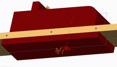

Here's the model with loads and constraints (click to enlarge; the ramp loads are a bit buried, sorry):

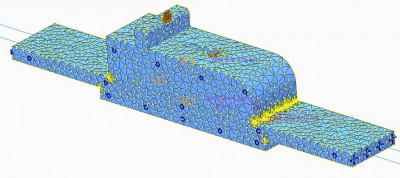

Mesh and Solver: the mesh has controls on element size and quality and refinements in important corners (as small as 0.001"). I used Creo Simulate (Pro/Engineer Mechanica), which uses higher-order "p-elements". Here's a mesh of 45k tetrahedral elements:
Limitations: As Trevor mentioned a bit ago, FEA is not the real world, although it is a pretty sophisticated model of it. Some things are hard to simulate, such as the stresses in an inside sharp corner. Mathematically, there is infinite stress (a "singularity") at the very corner edge. Real materials experience microscopic yielding there. So, FEA stresses are increasingly inaccurate as the corner is approached. There are a number of standard techniques to handle this, though:
1) Make the corner elements really small to confine the singularity to a tiny region. Ignore the stresses in those elements. I used 0.001" elements in the bridge-top corners.
2) For stresses very near the corner, never rely on the absolute stress value; only use for comparison.
Other limitations above.

Resulting deflections (sanity check... not very meaningful with ballpark iso Es):

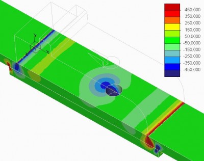

Below are the stresses in the vertical direction (Syy), sliced through centerline. The front and rear corners show very large stress concentrations: compresion (blue) and tension (red). The middle shows the propogation of the ball-end load through the thickness, meeting with the string ramp load -- a self-equilibrating "stress column".
Here are stresses in the vertical direction applied to the top surface (same as the pressure distribution on the bridge bottom). That ball-end stress column shows up as the "R" distribution.
David Malicky
Posts: 60
Re: Purpose of bridge pins?
Post by David Malicky »

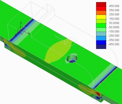

The shear stresses on top surface are similar to the vertical stresses, except for sign:

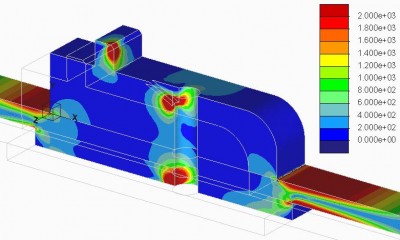

Finally, here are the Von-Mises stresses on the centerline and top surface (V-M combines shear, normal, and all other stresses in 1 number. These plots have a different stress scale.)
So, there are huge stress concentrations at the front and rear of the bridge. That can be interpreted in a few ways, I think equally applicable:
- The bridge mostly behaves as a rigid body for these torque reactions.
- As the bridge's rear is pulled away from the top, the tension has to negotiate the sharp corner. This is similar to the classic stepped-bar in tension stress concentration. Bad sharp corner, bad.
Feedback, concerns, and suggestions on the model are welcome! I'm currently working on material and geometry variations to see relative effects. Also a model of the unglued bridge (hard to do... non-linear contact).

Love the color!
(and the analysis!)
Posts: 3191
Maybe that sharp corner is what drives the top. May be a good thing!
Another option is we are seeing impedance mismatch. Just throwing out ideas here.
I like the Von-Mises plot. That's getting saved.

Interesting, and still digesting the findings....
Can you please repeat the tests, with a 15/16" wide bridge with a bridgeplate at exatly one inch wide, centered under the bridge? And perhaps increase the string tension to 28lbs.
I ask because personally, I've seen more problems on heavily built guitars than on very lightly ones, and I've long suspected stress risers in the heavily built ones as the likely culprit(poor workmanship would be my second suspect...). I'm interested in seeing what the modeling will show!
