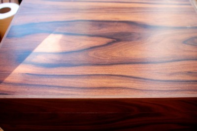

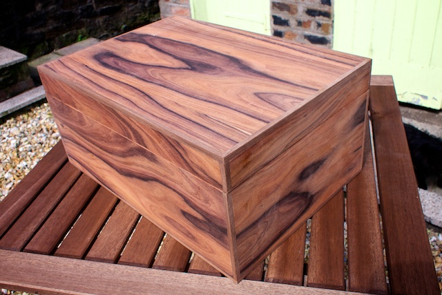

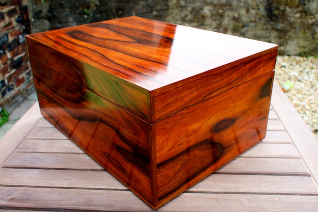

Here's a Humidor I made with a Santos Rosewood Veneer, The first image is prior to french polishing and the second is with sanding sealer alone and the third with multiple coats of 50/50 button polish and mentholated spirit as instructed by my furniture finishing tutor:
You can see how much redness it imparts on the walnut binding along with the lighter parts of the rosewood:
