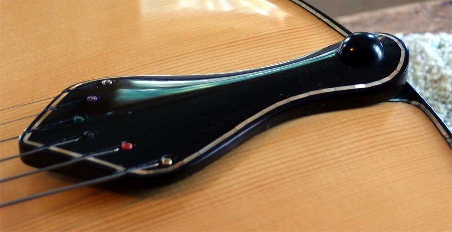

Here's a shot of the tailpiece on the 'Winter' archtop. You can see the top of the ball on it's post, and catch a glimpse of the ebony inlay reinforcing the hole in the top. The tailpiece is Macassar ebony, as is all the dark wood on this one. The black outside of the pearl purfling on the tailpiece is actually a binding. The ball ends of the strings seat into back-angled holes in the top of the tailpiece, with short pins that are there to keep the ball ends from rotating and popping out. It's based on the Elliot pinless bridge design, but without the brass liners in the holes (which I didn't know about when I made it).

That's some finely crafted pieces of ebony there Alan.
