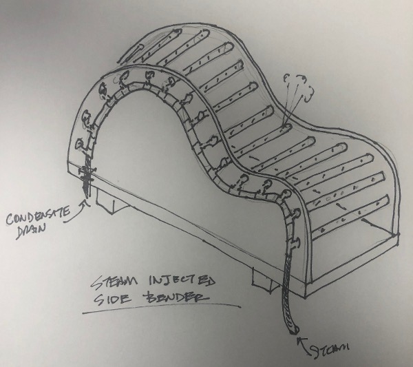

DJ Parker
Posts: 113
Location: Jacksonville, Fl.
Re: A Different Way of Steam Bending
Post by DJ Parker »
The sketch is a bit off but, I wonder if this would work? ;)
