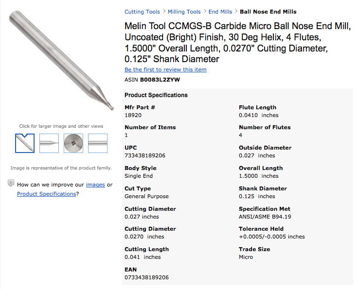

I found this at Amazon Supply. I think that this will work.

Most rosettes are cut on a drill press with a rosette cutter. The cutters I've seen and worked on have different width chisels that slide in and are locked into a track. There's a centering pin that goes into a 1/4" hole you drill through the top and into a work block underneath that keeps the cutter centered and on track.
If you want to use a Dremel tool and circle routing jig to rout the narrow channels you might want to start with a 1/16" or 1.5mm cutter. You can buy these very inexpensively in any diameter off ebay. They are used to mill and drill printed circuit boards among other things. I usually buy them in packs of 10 or 12 shipped from Hong Kong or Mainland China. It does take about 10 days to get them. Domestic sources like http://precisebits.com have better quality at a much higher price. I know I'd much rather snap off a $2 bit than a $24 dollar one though I tend to be much more conservative with the domestic ones so they do last a little longer. When cutting into a spruce top you just want the sharpest bit you can find. I would never be able to do this job cleanly with my collection of miserable Dremels so would recommend you use a trim router instead. I'd use this bit:

My dentist supplied me with a lifetime's worth of tiny, precise router bits all the way down to about .020"(0.5mm).
The "trick" to doing the very narrow cut in spruce is to take many, very light cuts. No more than about .010" per pass. Otherwise, you'll either snap the bit, or it will wander around some in between the early and late(IE: soft and hard) growth lines.
