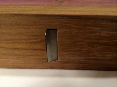

Here is a close-up of the throat of one of the block planes. I usually adjust the blade to take a minimal shaving - you can't read through them, but close.
The Hock blade is pretty sturdy, so I don't get much chatter, if any.
