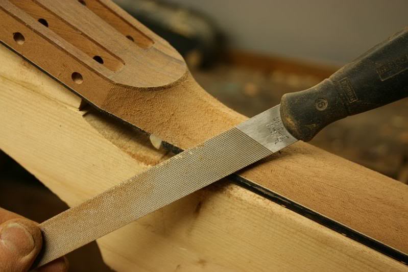

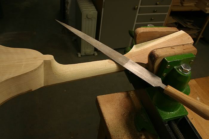

I started with a couple of Sandvik rasps and files, because that's what I found at the hardware store. Then got a Nicholson 49 and 50 about 10 years ago, because everyone said they were better (and they are, IMO). Later, I got some handmade Chinese rasps from Dictum, probably the same as the Dragon rasps, which are nice, but a lot less agressive. I also got a pair of Arious, which are lovely, but not as useful as the Nicholsons. My favourite is still the 49, in combination with the old half-round Sandvik file, before sandpaper etc.
I hear the new Nicholsons are not as nice, but you can get them sharpened and "upgraded" to better than new condition. I believe I read it here...(?)
Found a couple of older picures to illustrate
Here's the surface after the 49...
...then, after a few strokes with the Sandvik file
The Chinese rasp (same as Dragon?) leaves a finer surface than the Nicholosn, as I said. Even if I don't use it that much, sometimes that can be just the right thing
