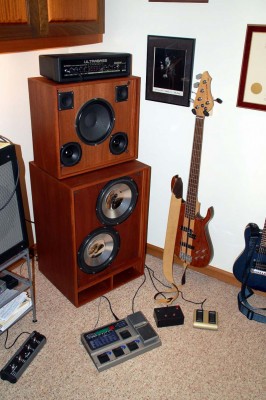

I built one of the fEARful 2 x 12 cabinets for my amp and loaded it with two twelve inchers that were designed as subwoofers and then added a 10" cabinet with a couple of horns/mids and it moves things inside my wall when I let the low B rip. It is an amazing design and pretty easy to build.
Finished build before I put on the grills. It is all mahogany.
