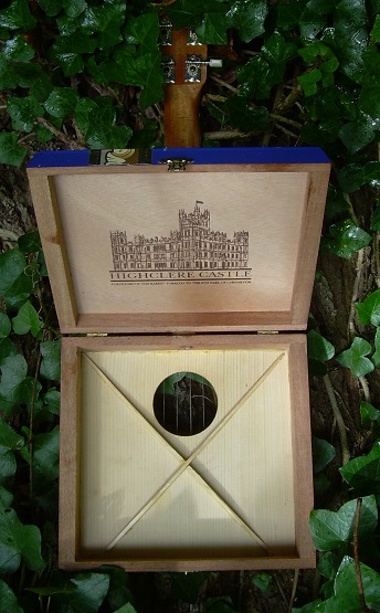

Your inquiry prompted me to look into the Asian offerings for premade necks. Someone gave me a bunch of cigar boxes that I am turning into ukuleles and the necks on offer looked like an economical way (both money and time) to do this project. I can report I am happy with my $10 purchase.
I checked the fret spacing against the Stewmac calculator and the frets appear to be accurately spaced. The frets are well seated and the fret ends neatly finished off. The neck I believe to be luan and is reasonably well formed. Adding a neck stiffener might not be a bad idea, since a tenor is tuned to the same pitches as a soprano. The peghead is scarf joined and the predrilled tuner holes are over size for the tuners I have, so I will plug them and add a face veneer. The tuner plate should cover the plug in the back.

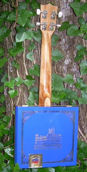

The neck was made so it joined the body at the 14th fret.

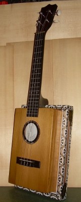

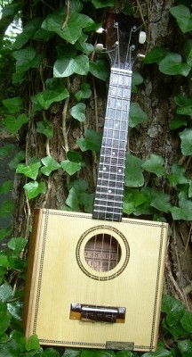

If you find a tenor scale doesn't fit with the bodies you have, you can shorten the fret board by two frets and make a concert scaled instrument. That is what I did for this cigar box uke. It throws the marker dots off a little, but that's not a big deal, and if it bugs you a black marker could eliminate them.
