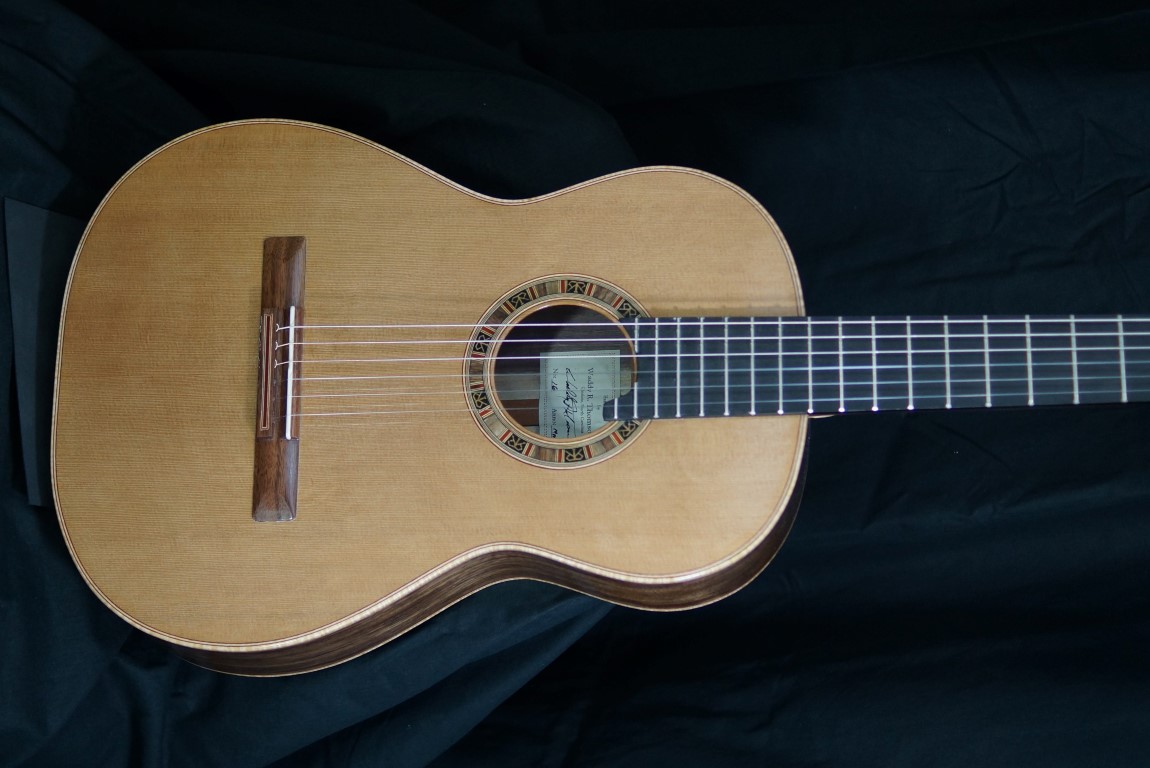

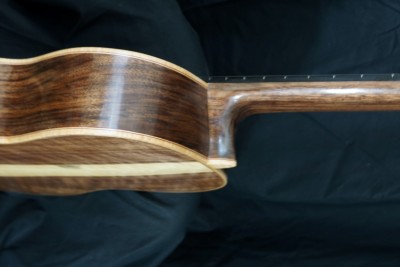

As said, it depends on what you are looking for, but if you are willing to build with non-exotics, like Walnut and Cherry, there are some pretty good looking sets out there for not so much. Check out Hibdon Hardwoods. Their domestics are pretty reasonable. Here is a classical I build from a set of their standard Walnut. Something like a $60 set.
