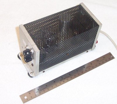

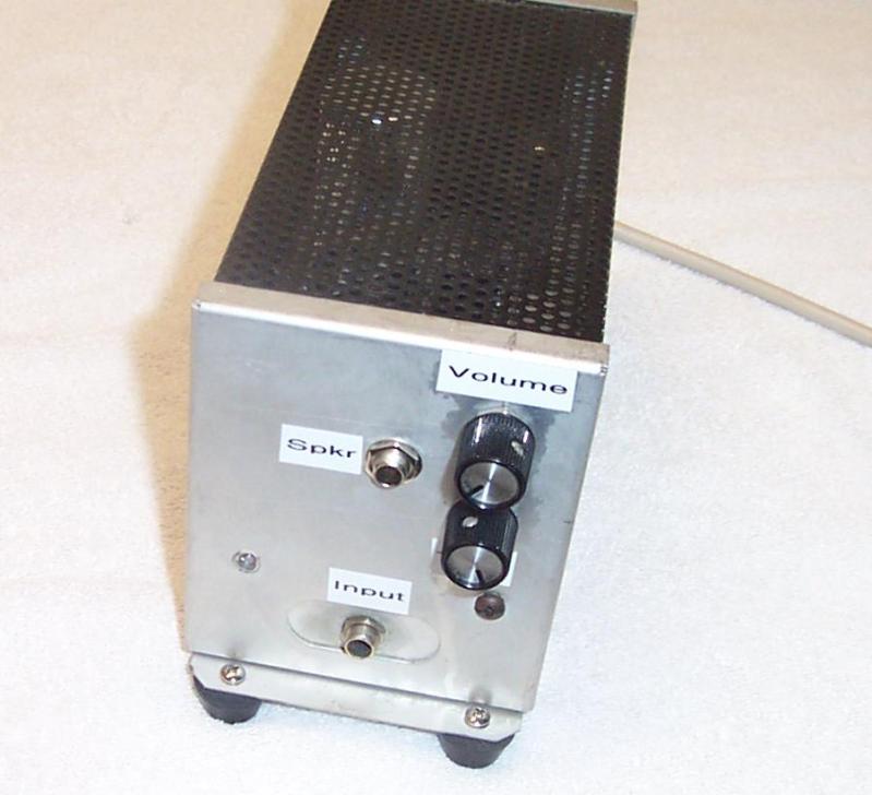

A friend of mine builds tube amps from old TVs, stereos and other bits of electronic junk. He recently put together this little gem and when I heard it I just had to have it. So we made a trade and I'm going to be doing some work on an SG project we wants to get started on.
It's made from an old Electrohome FM Multiplex unit. He designed the circuit that he put into it... which I really don't understand anyway. It uses a 12ax7 preamp tube and a 6sn7 power tube. It has incredible sounding overdrive for such low wattage.
Here's his YouTube video... and I'll post some pictures.
http://www.youtube.com/watch?v=CHVwA6KpzpI
It measures about 9" long x 4" wide x 6" high

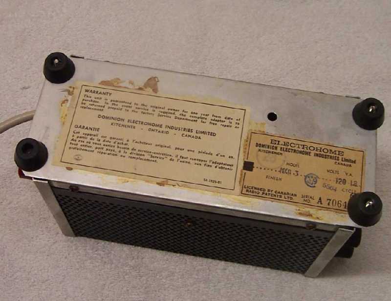

The original Electrohome stickers are still attached.
