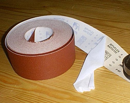

Good timing on this discussion. I'm about to put paper on my new thickness sander and the factory has sent me the velcro. I'm not going to use it just for the same reason that's discussed here. But I'm wondering if anyone sees a problem with using the paper which has a cloth backing much like thin linen that the velcro hooks attach too. Also after reading through the library everyone says not to glue the paper on. My drum is 3" dia. solid steel except at the ends where the bearings and pulley are. Has anyone tried to use carpet tape on the drum? Or do you all think it would also be a PITA to change the paper. And if not wrapping the whole drum then what about the ends?

Okay, I followed Larry's method. Pulled the cloth off the 80 grit paper. This is their hook and loop paper and there wasn't any stick left on the paper if that matters.
Paulick, Chris - 05/09/2008.16:32:34
Then put a 3/4" wide piece of carpet tape around the start and wrapped on the paper and same tape at the end and two wraps of strapping tape over that. Okay? See any potential problems?

They all turn bottom of drum toward you and top of drum away from you at the in feed. Unless the drum sands the bottom side of the board. I haven't seen any like that though. I not sure it matters how it is wrapped because regardless if the start point comes loose then the paper comes off. If you look at the way mine is wrapped in the picture. If the right side came loose then it probably would flap but if the left side came loose it would come off. If you reversed the wrap then it would react just the opposite. It might make a difference as to which direction the paper goes off. I never really gave it any thought before I ask the question. I don't think it's like a nut getting tight on a revolving shaft. At least I don't think so. But what do I know I ask the question in the first place.
