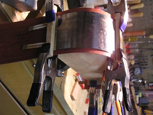

Brian, my bending technique is very simple. The pictures show bending of binding but it's the sanme for a side. I spritz the bare wood at the waist with water, and then slightly overbend it with a hot pipe. I immediately clamp it to the mold as shown in pic #1.
After about ten minutes it's "set" so I pull it off the mold and put the blanket on the mold, next the wood, next the stainless backer. Aklignment is important. The only place the wood is touching the mold yet is the prebent waist. I spritz the wood on both sides and turn on the blanket at high. It gets very hot very fast so I start bending in about a minute. I pull the upper bout down, clamping retainer sticks over the metal backer as I go, this takes maybe two minutes. Once the upper bout is bent I spritz the outside of the backer really good at the waist and upper bout to keep it from getting too hot, and I may turn the blanket down to about 7/8 or 3/4 if things start smelling burnt. The lower bout is the same procedure, same amount of time.
As soon as the lower bout is bent I turn the blanket to about 1/2 and cook for about five minutes. Then I remove the backer as shown in pic #3 and cook for about 15 minutes to get all the water off.
I'm sure a dry bending technique at lower temps would also work fine. The only difference between my rig and a fox bender is that the wood is pulled down using the hand and held down by clamping a retainer stick to the rim of the mold.

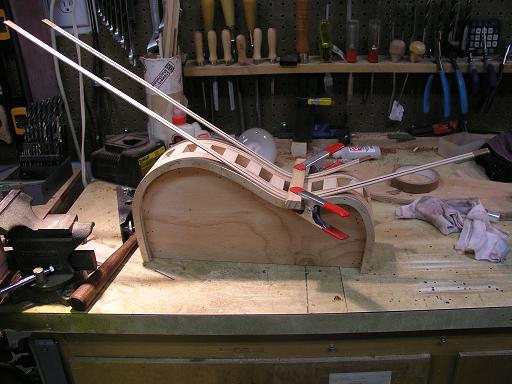

Picture #2 shows the lower bout right after bending. You can see the binding sticking out.
