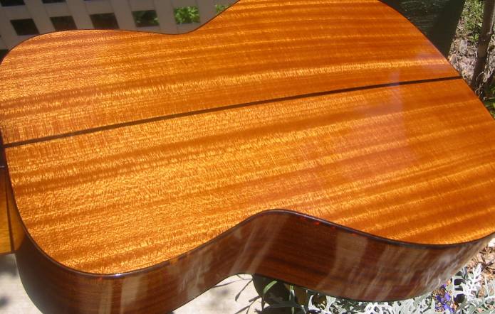

Tweedy, Chuck - 02/05/2008.00:31:56
Sanding and buffing are a waste of time!
Does this hold up? It is straight off the pad - no sanding, no buffing. Do you believe me?

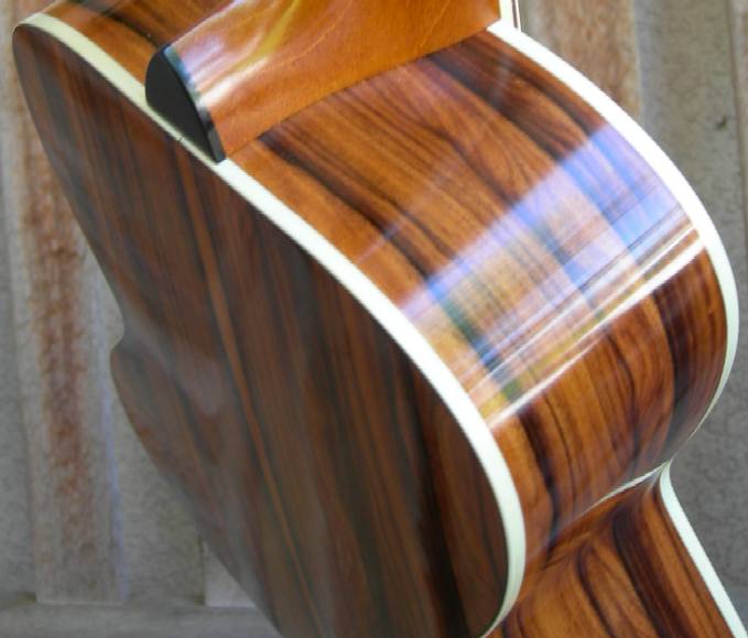

Tweedy, Chuck - 02/05/2008.00:36:31
And another.

Tweedy, Chuck - 02/05/2008.09:46:08
I can't claim that I know how to finish with fancy spray gear and big buffs. I don't have that stuff (nor do I have the space!).
My point is that if you use the "processes" of the French polish method effectively, it is easy (and FAST!) to develop a robust film with good shine.
