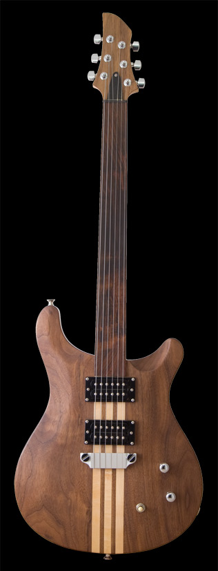

By the time I finished my 4th guitar, my 2nd guitar was somewhat of a disappointment. The neck was way too thick, the headstock too thin and deformed, the tuner holes were not drilled in the right spots, the walnut fingerboard felt awful, the frets were a mess, the neck heel was way too big, the top was carved poorly and the recurve was cutting into my arm when I played, the finish was ugly and full of dust and cat hair, etc, etc... But I didn't want to leave it sitting in the corner unplayed. So I got the big idea to transform it into an instrument I'd never played before: a fretless electric guitar. So I pulled the fingerboard and replaced it with piece of Brazilian Rosewood I found in a scrap pile. Then I cut almost all of the headstock off and scarfed a piece of maple to what was left, added some maple ears, then veneered both faces with walnut. Then I reshaped the neck, heel, and top, and then carved a belly cut for the heck of it. When all the sanding was done, I finished it in Tru-Oil, and then realized that the original bridge was way too high for even remotely playable action. So I ended up cutting one out of a chunk of aluminum, and to my surprise, it worked alright.
PRS style Walnut/Maple neck-through
Brazilian Rosewood fretless fingerboard
Flat radius
No markers, no sidedots, no idea where my fingers are
Schaller tuners
Stewmac hotrod trussrod
No name eBay pickups
Aluminum one-piece bridge
Delrin nut
.013-.054 flatwound strings

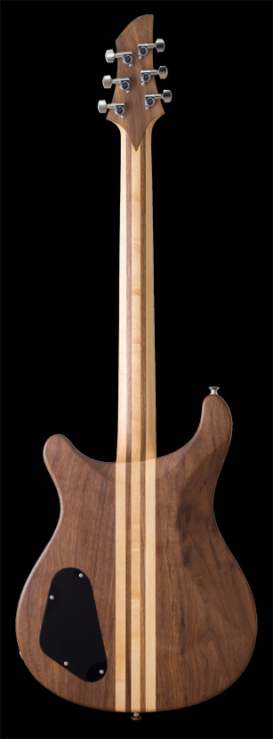

Here's the back

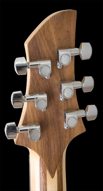

Serrels, Shawn - 02/22/2009.19:15:38
Serrels, Shawn - 02/22/2009.19:16:06
Serrels, Shawn - 02/22/2009.19:16:25

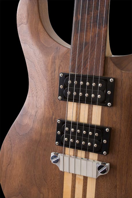

Serrels, Shawn - 02/22/2009.19:20:59

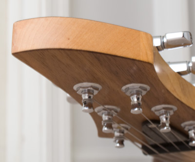

Here's the only evidence of the new headstock splice, the Walnut laminations in the neck mysteriously disappear:

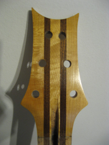

Here's the old headstock for comparison
