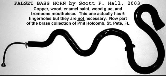

Scott Hall's method of making a FALSET BASS HORN - if you can't afford a serpent [Pictures] - created 06-06-2006

Here's a pic of a new falset bass horn I'm making--this is in-progress and all ready for finish (multiple coats of sprayed and sanded black paint). I made this one by sandwiching three layers of marine grade plywood: 1/2" to 3/4" to 1/2". The thicker center layer had its bore cut out prior to lamination (i.e. jigsaw cutting the bore on that layer means that a rectangular bore is easily created through the full length of the horn once it is laminated together). The fingerholes, by the way, were drilled prior to lamination. At the top (not quite visible), there is a 1/2" hole drilled in which to mount the half inch diameter copper leadpipe (using a tenon on the copper pipe made simply of dental floss and soft orthodontic wax).
Hall, Scott - 06/07/2006.10:16:38
Merritt Island and Orlando, FL U.S.A.
The above horn is octagon shaped on the outside--this shaping is done after lamination. I simply cut those edges off to make the octagon with the jigsaw blade angled to 45 degrees. And by the way, this is the horn I was emulating in making this one--it's a bass cornett (early serpent) from about 1500 A.D.
