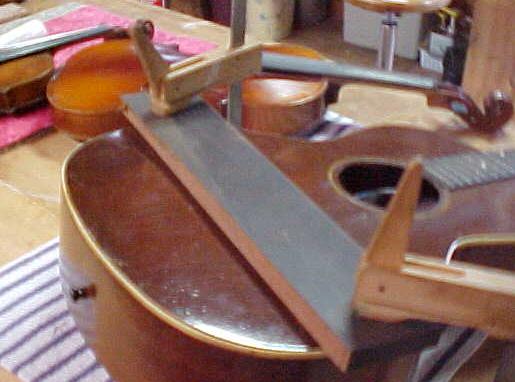

A friend has asked me to try to repair the bulging top of her classical guitar, and I really don't know where to begin. Years of string tension has caused to top to bulge fairly dramatically at the bridge. thus, causing the action to be very high. I would like to reduce this as much as possible to make the guitar more easily playable. Any thoughts?

Because of the classical guitar bracing, repairing a bulge may be more difficult than on a steel string. Usually it is not as much of an issue unless, as Deb suggests, it has been strung up too heavily. I start with heating and pressing the top but you need to have a good peek around the inside with light and mirror to check for split or loosened braces.
Thorne-Thomsen, Eli - 11/20/2008.05:40:31
The action at the 12th fret is a 5/16th of an inch. I will post pics as soon as I get a chance.
Th guitar may have been strung with steel at some point, but when I got it it had nylon. The bracing seems to be sound. Nothing loose as far as I can tell. I can't believe how lightly this guitar is braced(I am used to steel strings). When applying heat and pressure, how hot and how much? And, do I need to remove the bridge?

Eli, I've mostly done this on steel string guitars, with the bridge removed I heat the top. I use a heat lamp, moving it around, and I watch it like a hawk every second. You want the top to get really warm, so that you can touch it with your hand but just barely. A tiny bit too much and you can have finish damage. Then I clamp the top with a very straight board and let it cool. Make sure that you check for any loose braces before and after this procedure.

Amy, Thanks for the advice. I will try it. I will have to get my wife to test the heat. I am a chef and my hands are fairly desensitized to heat. I will post results and/or more questions.

Are you sure top doming is the culprit?
Is the soundboard region in front of the bridge concave?
It's very possible the neck has pulled up. You might consider slipping the foot, unless it's a dovetail neck.
You might want to remove the bridge before trying to iron the soundboard straight. Then replace bridge or stiffen the old bridge with rosewood veneer.
If yellow glue (tightbond) was used, heat is all you need to lift the bridge and separate the back and foot. If it's hide glue, you'll need steam.
Careful with old lacquer, it ignites at low heat.
