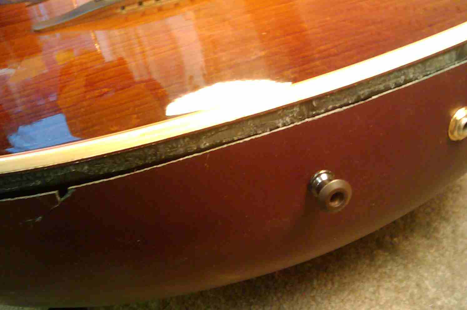

Hey everybody, Need some advise. I have an Ovation guitar with the back almost all the way loose. The customer's girlfriend smashed it against a wall!!! so the back got unglued where the kerfing meets the back, there is no kerfing and there is a crack on the side. My question is: How to clamp this oval back and what glue to use. I'm thinking I'll need to make a jig for the clamps to have a surface to hold on to and I was thinking epoxy or weld-on #16.
Any advise will be appreciated. I'm attaching some pics

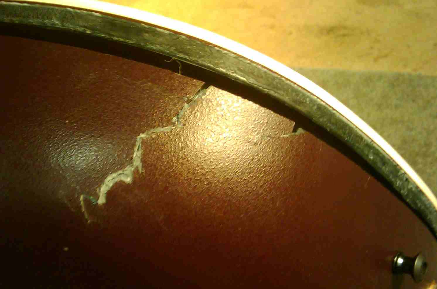

Martirena, Ivan - 12/09/2008.13:39:11
Another pic

I'd repair that crack before gluing the back on.

Ovations are my thing lol Ive been playing and repairing them for some years. Dont bother building a jig. Get some rubber tubbing that will strech. Surgical tubing works great. Looks like the top ring has seperated from the bowl. Has it seperated all the way around?
Going by the brown bowl paint im gonna say its a 1980's ovation with a bolt on neck. If it was me doing the repair id pull the neck and gently,verry verry verry gently finish the seperation from the bowl.
Once you have the top off you can go about laying some glass on the inside of the bowl to reinforce that crack.
To reattach the tops i use epoxy on the ones with a fiberglass top ring instead of wood kerf.

Hi,
The first thing is to remove the neck. Most of these bowl back just bolt on, maybe with tongue glued to the top (this is removed with heat and a thin sharp spatula knife).
Next, make a workboard from 1/2" thick ply or thicker that is the same shape as the top but a little bigger all the way around (maybe 1/8"). You'll need to rout/carve a depression in the board where the bridge is. This is so the the guitar can go face down on the board flat.
I use a good epoxy (West System) dyed black with lamp black pigment. Work it in everywhere its needed (don't forget to wax all around the cracks so the clean later goes easier, but be sure not to get any on the actual gluing surfaces).
To clamp, wrap the body and work board with those large, industrial elastic bands (lots!) and leave to dry.
Hope this is helpful, good luck!

Oh yeah, for the cracks in the bowl, use the same black epoxy from the inside and reinforce with fiberglass mesh as Mike said above.

Martirena, Ivan - 12/09/2008.18:16:23
Thanks all, Mike you are right, it's a bolt on neck and it does go around till the tongue, still attached there. I'll try to use the big bands and fiberglass reinforcement from the inside. I will post pics once it's done.

I used as much as 150 bands and finalize it with the latex tubing to hold the cracks in place. I also used epoxy 30', but I wished I had used a longer setting (1 hour or more) since it took longer to get the bands in place than during the dry run...
Other than that, everything turned out great! The crack was fixed with drywall joint tape and epoxy from the inside.
