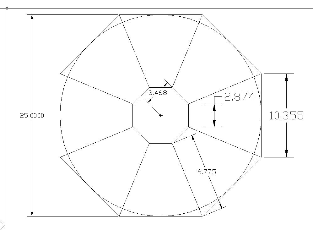

Palen, Nelson - 03/22/2011.22:56:24
luthi, luthier, luthiest?
I used this method years ago to make up a 25" diameter using 9"x11" sheets of sandpaper to cut and glue segments to the disc. It's a bit of a pain to glue them down but it works in a pinch.
