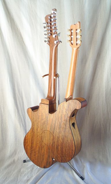

Hi folks,
Here is the last big one out off my shop. 'She' is based on customer specifications and 'she' calls Lernaean.She has a 'classical' neck, an 8 strings bass+guitar neck with 12 sympathetic strings and 8 trebles strings with levers and fine tuners.
WRC & Spuce top
Ovengkol B&S
EIRW fingerboards, bridges and binding
Spanish cedar 'classical' neck, 645mm long
Mahogany 'folk' 8 strings neck, 715mm long
macassar ebony heads veneer
PickUpTheWorld custom pickup for each bank of strings, preamp and separate outputs.
and more than three dozen of tunning gears.
And now, some pictures....

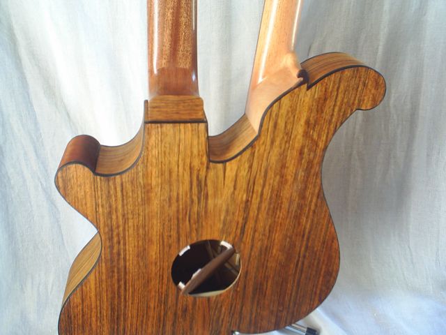

There is a door in the midlle of the back to acces electronics...

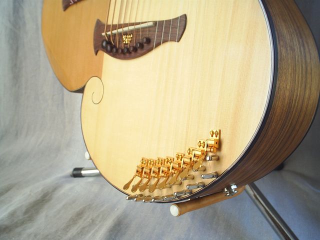

....and sympathetics strings.

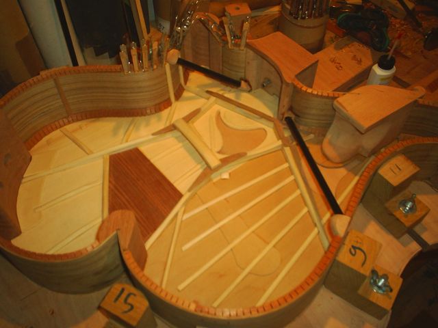

Are you curious?
hummmm....... inside view.

There is one thing about it that is nagging at me. It speaks to the question of what does one think about and plan for when designing an instrument like this?
What comes to my mind right away is the shape of the top, and how the string layout fits into it. The biggest thing that I question is the position of the two bass strings on the top....good bass notes require more movement of the top than does high notes or strings. If you see where those bass strings anchor to the top, it's right at that spot where the two sides meet and come together, and there is a lot of bridge plate at this same spot. To me, this part of the top doesn't seem like a very flexible spot and I would expect those bass strings to be a bit weak.

I had the same dilemma about bass part of the 8 strings neck. But such a custom instrument is full of compromises. Customer came with precise requests about instrument holding and playabilities. I informed him about incidences which such a shape could have and he also made some compromises. Fortunatly, those bass does not sound that weak. Maybe the lower F and E are a bit weak. Bass frequencies are really big when plugged and enought sounding unplugged. In fact, customer play mostly pluged with a loop pedal system.
for the joke: Have you ever heard an ArchLute in live? It sounds with deep bass although there almost no room back the bridge.
In short,acousticaly 'she' sounds very well balanced exepted on the very low E and F at my own surprise.

Exotic and beautiful ! Thanks for the interior pic. It seems you have two carbon fiber spars in there.

There are carbon rod reinforcement for the 8 strings neck 'cause the body is quite wide and I have to stiffen this part of the body. The two main 'curved' braces are not curved but its a multi layer spruce interlocking bracing system with (about) 35deg angle in the midlle. It is a good technic 'cause it react as a uniform 1 piece brace, even stifer.

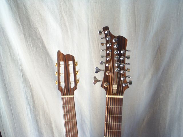

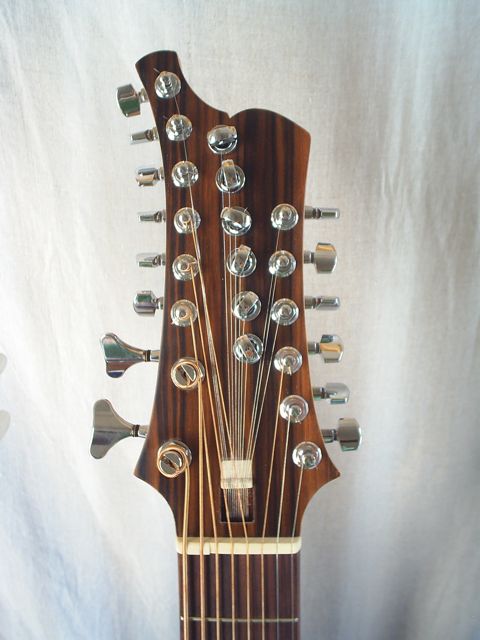

Would you explain some of the hardware? I don't recognize the tuning keys in the center of the headstock. Are those sharping levers on the treble side harp?

Dwight, on the clasical head there are clasical schaller tuner, on the 8 string head there are 2 goto bass tuners for the 2 lower strings, 6 mini goto tuners for the main 6 strings, 6 mini goto tuners for part of the sympathetics strings and 6 steinberger tuners for the others 6 sympath. on treble strings, each have a dulcimer like pin tuner for global tuning, a violin fine tuner for ... fine tuning and a Dragonwhispers harp lever to raise the note half a tone up.

Far out, I just looked closer and noticed that the sympathetic strings are anchored to the 8-string bridge, threaded from the outside. I thought that was a little gold inlay to compliment the harp levers, but it's a cluster of ball ends. So there are strings pulling up AND down on that bridge. I suppose that's an effective way to couple the fretted string vibrations to the sympathetics.
What does the core of that 8-string neck look like? A channel down the center with two truss rods, or just carbon fiber rods?
That thing is chock full of creative solutions to the forces at play. Nice work!
Lamour, Pierre - 06/26/2010.14:44:38
French harp-guitar maker
There's no trussRod but a channel made two 3/8 x 1/4 carbon rods (no pict, sorry)
Yes it's a cluster of sympathetic strings ball ends. About down pressure on the bridge, the strings are low tensioned (from 8 to 10 lb ) so there is a small amount of down forces. the 8 strings are about 300lb (hight tension for some slide playing) so sympathetic strings counterbalance of 15% of the main strings tension.
