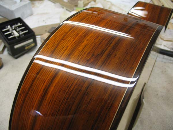

Here's one I buffed recently: cocobolo(thanks, Larry!) and ebony bindings, under fluorescent lights. If there's a combination that will show the shortcomings of a finish, this would be it, yet look at the clarity and gloss, and again, no pore filler was used.

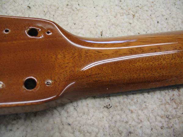

Proulx, Mario - 07/25/2005.23:11:02
Hear the colors....
Here's the same guitar's neck, straight from the gun, without buffing.

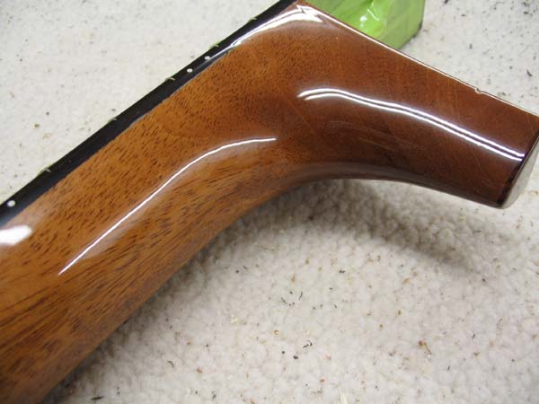

Proulx, Mario - 07/25/2005.23:11:46
Hear the colors....
Same neck, again, no levelling, no buffing, yet. Note in this photo, and the previous one, that the finish is heaviest at the edge and around the holes! To anyone who's buffed-through at an edge, this is lovely to see
Marchand, Ryan - 07/26/2005.16:06:39
WOW! That's just wild! Heck, I wish some of my finishes looked that good AFTER buffing (very sad, isn't it....).
