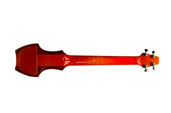

BTW, the finish was KTM9 over epoxy filler. And here's a pic of the back...

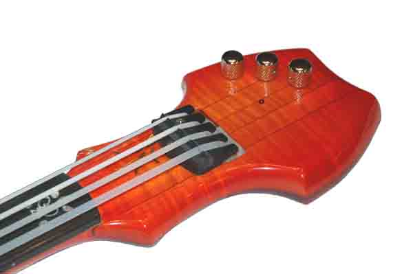

and a closeup of the body...

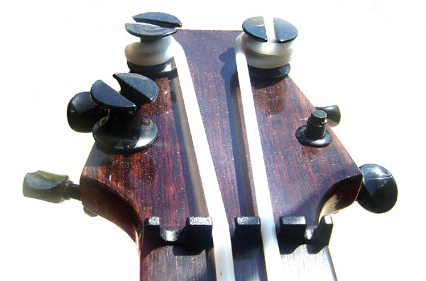

The following picture should clarify the tuning peg issue. Unlike most tuners you can see that the roller part screws onto the tuning post's reverse thread, so the G and D strings will naturally tighten on. On the other hand, the E and A strings tend to unscrew it... so I drilled a hole through the center of those rollers with a small brad inserted, going through the post.
