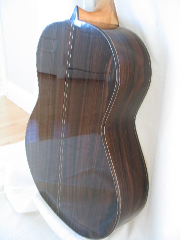

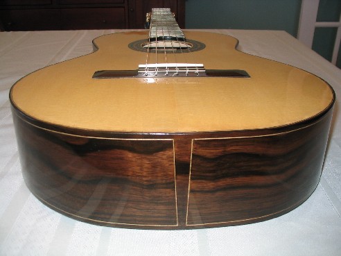

LaCroix, John - 03/30/2004.20:25:43
a shot of the tail...

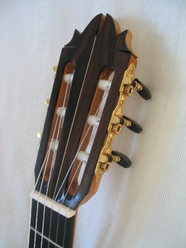

LaCroix, John - 03/30/2004.20:26:14
the head...

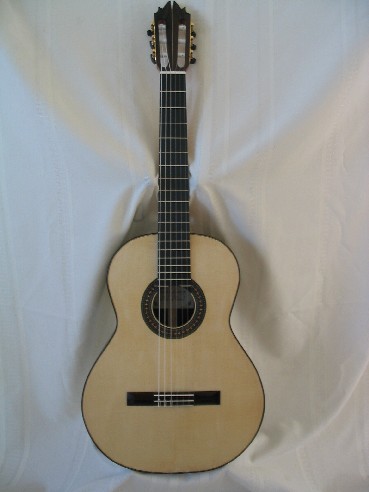

LaCroix, John - 03/30/2004.20:27:11
the front (not the greatest picture). I haven't figured out how to do good full frontal shots yet..

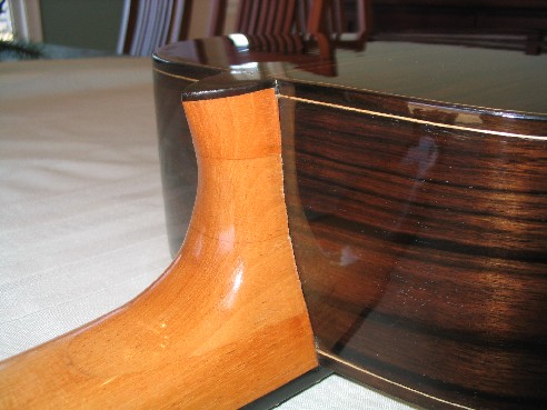

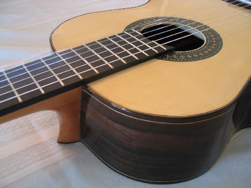

LaCroix, John - 03/30/2004.20:28:19
detail of the heel...
LaCroix, John - 03/30/2004.20:28:51
One more - detail of the neck joint/upper bout...
