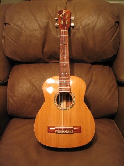

PATTILLO, ERNEST - 12/27/2006.22:58:44
This uke is a tenor finished this year. It has a western red cedar top, curly maple neck with ebony stripe all the way through, and the sides and back are of bubinga. Has a nice sound to me, but since this the first one I've heard or built, I have no idea how it really sounds.
PATTILLO, ERNEST - 12/27/2006.23:02:48
Here is the front view. I think it turned out pretty well for a first one. The sound hole rosette is abalone with bubinga wedges and maple wedges and ringed with bunbinga. I also put some abalone as decoration on the tie block of the classical style bridge.

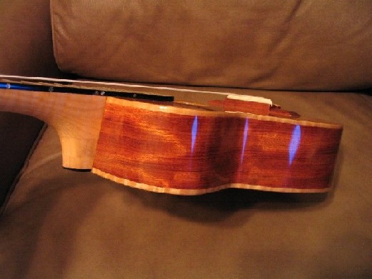

PATTILLO, ERNEST - 12/27/2006.23:07:37
Oops, forgot to say it's bound with curly maple. Here's a side view.
