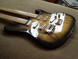

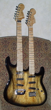

Hauri, Erik - 02/22/2005.20:42:11
I've been lurking here for quite some time, posting only occasionally. This is the result of all the great advice here, an unbelievable amount really. Thanks for all of it.
Specs:
Alder body
Booked spalted maple cap
enamel blackburst, polyU clear coat
flame maple necks, walnut skunk stripes & headstock lam
25.5" scale, 1.75" @ nut, 16" radius, jumbo frets, bone nuts
chrome dome pickups, standard stratty switching
master volume & tone, 3-way neck select
The tone is surprisingly meatier than your standard strat, lots of sustain and the 12-string is a dream. The cavity covers are from the same spalt billet as the cap. The 12-neck has only 6 tuners; the octave strings are strung through the tailpiece, tuned up, clamped with the string clamp, snipped and thereafter adjusted with the fine-tuners. The regular strings thread through the body, pass through holes drilled through the string clamp, and are tuned in the normal way with the tuning keys. I had to do it this way, as I absolutely wanted the headstocks to match.
12 pounds, but I love it!

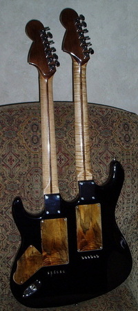

Hauri, Erik - 02/22/2005.20:46:18
Here's the back.
Hauri, Erik - 02/22/2005.20:48:07
Finally...after 4 tries (a lot, especially for this size body)...finally, a good finish!

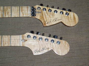

Hauri, Erik - 02/22/2005.20:50:55
And the headstocks.

Hauri, Erik - 02/23/2005.11:42:03
Thanks everyone!
I did indeed see that doubleneck winner in Guitar World, when I was about half-way done with this one. I thought "heheheh...I got that beat!"
The cavity covers were required because the pickup routs & wiring were done from the rear. The bridge is a Schaller, normally used for 6 strings; all I had to do was drill the string-thru holes in the right place, and notch the saddles properly.
The 6-neck is a 1-piece, the 12-neck is 2-piece (back + fretboard). The 6-neck was actually fussier to adjust (moved around more) than the 12-neck, despite the lower string tension. It is my first, and last, 1-piece neck.
The 6-neck was shot & buffed after fretting; the 12-neck was shot & buffed prior to fretting. Now that I've discovered the joys of Abralon sanding pads, I prefer the first method.
The balance is fine, both sitting & standing. I go 6'2" and 235 lbs, so this is not really weighing me down...if you know what I mean!
It will debut in our church, sometime in the next few weeks.
