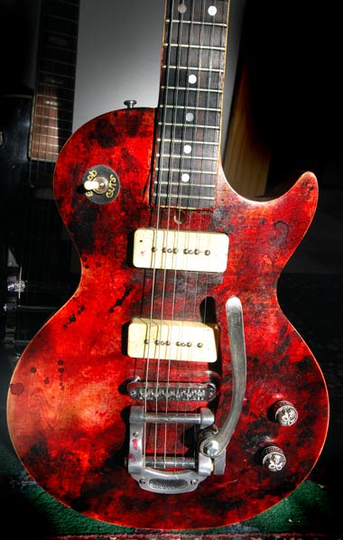

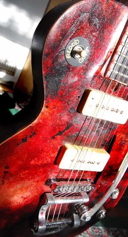

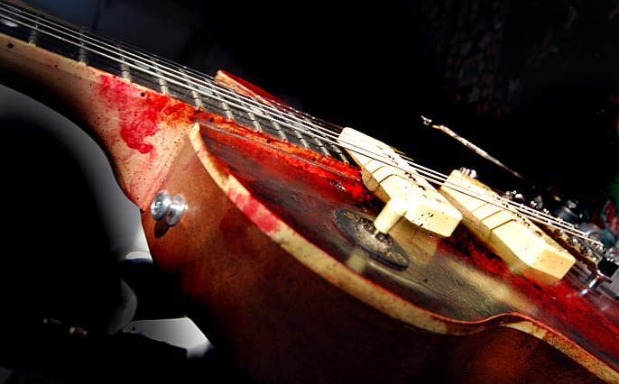

A bit of long boring history:
My first guitar was a 1973 Gibson Les Paul Custom I bought off the street from a guy who wanted to go buy a bag of weed.
It was in Milwaukee in 1975
It was heavy, I had no clue how to make it sound good, or an amp that didn't have huge orders of suckitude.
I hated it, so I dumped it for twice the money and gave up guitar playing, bought a camera and became a photographer and didn't learn to play for decade.
I still can't play with a polished edge, but I make up for it by leaning into things and getting out on the edge.
Now we jump forward to 2006:
I got kicked out of my long time band last year for leaning into the music a little too hard for the rest of the middle aged farts I play with, and when that happened I decided that it was time to head for the other side of the electric guitar ditch, put those Elliecasters in the closet that I'd been using and go somewhere new.
I had two different people give me cheap Les Paul clones last year, old made in Japan versions. Seemed like a message to me, although from whom I have no clue.
I also have several amps now with no discernible orders of suckitude. So I embraced onboard filthy distortion, the Humbucker and started rethinking my unreasonable hatred of the Les Paul.
I love my black Japanese no name Les Paul, but it's got a pressed plywood hollow top, and after playing some real vintage Les Pauls my pals Erick and Gene had, I thought I'd see if I could find something to rebuild that wasn't hollow.

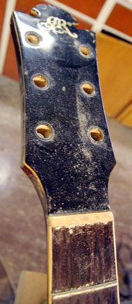

Mark Swanson swapped me this old stripped down Roland Synth guitar for a bunch of odds and ends.
It had a ton of holes to fill, a really, really beat up and thick polyester finish, and a cracked neck. We fixed the neck, and then I came home and filled the holes, routed new cavities on the back for controls, and sanded it down to bare wood and hacked the headstock, then covered it with a combo of red dyed shellac,some of my blood, sponged on nitro lacquer to give it a CSI sticky blood look.
It's a heavy beast, and a little too clean sounding for my taste.
Right now it's got a gutiarfetish multi distortion booster unit in it, a pair of placeholder P-90's from them as well, although I'm getting Clint to make me up a set of black and blood red P-90's for it.
The old bigsby clone is a bit stiff and sticky, I have to figure out what's wrong with that. It's got two skull knobs on it.
And it's perfect for the black lipstick crowd somebody once said I built for.

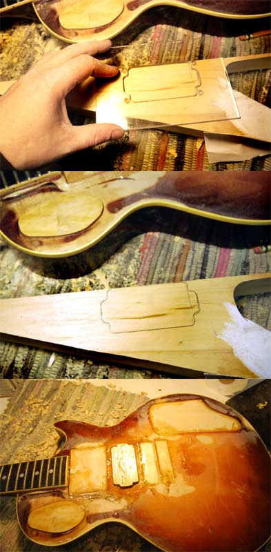

This is the body with some holes filled.
Erickson, Ellie - 01/21/2008.22:02:46
Erickson, Ellie - 01/21/2008.22:03:21
Filling the old, empty holes:

I recorded a sample of the various distortions today, I'll post a link to a non commercial site in the next day or two if anybody wants to hear this thing.
It sounds pretty good, but I still think I like the strange hollow and cheap sound of the black bolt on copy I have here.

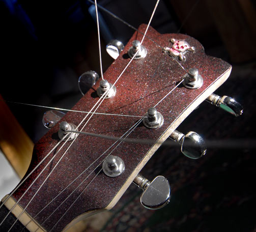

Cool, I like red guitars. Big improvement to the headstock too.

Now that I can see it I have a better idea of where to go on the pickups. Gonna over wind them a bit to get the darker low end. Yes... yes... it's all coming to me now! Mwahahahahaha!

I was thinking more along the lines of multiple decades of unfortunate powerchord strikes than Sweeney Todd, Clint. But that works too.
I think it would be good to have darker pickups for this guitar, it's almost too bright already.
