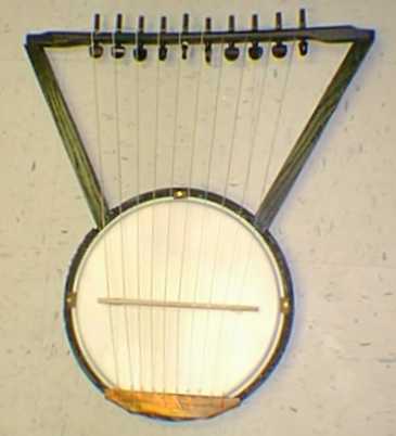

This is my second attempt to make a Nevel Asor (10 String Lyre) based on various historical data and a little artistic license.
The front is made of mylar (had no skin on hand to use) and it's painted brown for better looks.
I tuned this one in Ahava Rabba mode key of D: C D Eb F# G A Bb C D Eb, it plays pretty well.

That's pretty cool. How are the strings tuned? Friction pegs?

The strings on this one are tuned using standard zither pins on top like that on hammer dulcimers. The bottom are hitch pins. I took two sets of acoustic guitar string (the 5 largest strings) and paired them up. I then ran the end of the string through the little eyelet and put the loop around the hitch pin on the bottom and then connected the other end to the zither pin.
the nut on top is aspen wood and the bridge is oak.
The bridge is bowing a little and the mylar "skin" is a little tight in where the bridge presses against it.
The bridge also has a step on the ends to keep it from force the mylar skin down too hard.

I bought the mylar material at the Jo-anne Fabric store. It was thicker than your 0.003 stuff but I can't remember exactly how much. It also makes good artificial woodwind material. I'll have to measure it at my shop and see how thick it was.
The way I stretched it was by not stretching it. First I laid out the mounting holes and predrilled them. Then I laid the material in place. The bridge has a downward arch in the middle that presses on the mylar and keeps it tight. However, it is not a perfect system as the brige has the weight of 10 strings across it and it changes stress on the mylar with humidity.
In order to help the bridge out, I'm looking into making an "under-bridge" that will keep the bridge supported but hopefully help it in stability.

Ok, here it a picture of my original Nevel. This earlier design has a round body and I used a snare drum head for the skin.
The bridge on the newer one overlaps with the frame and has "hangers" to keep it from oversinking.
