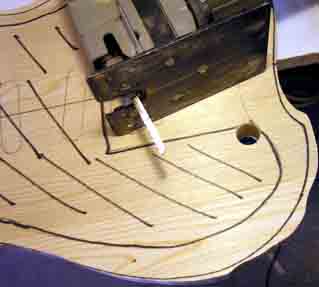

If you're going to use the strat style trem, I'd just make it a solid body pine guitar to the size you want the thickness of a strat minus the thickness of the masonite top and back.
Then I'd bandsaw the areas I didn't want out buy cutting in from the bottom end, then glue a splint in the slot where the blade entered to make the body whole again with the chambers cut out where you want them.
Then glue your top and back on over it.

Pine body, prepped
Erickson, Ellie - 02/04/2009.12:23:23
I did this one with a jigsaw, although the bandsaw method seems a little quicker.

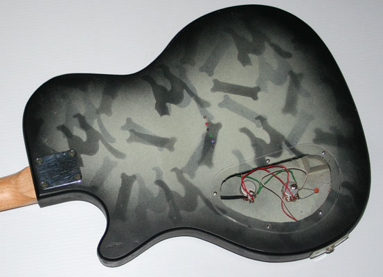

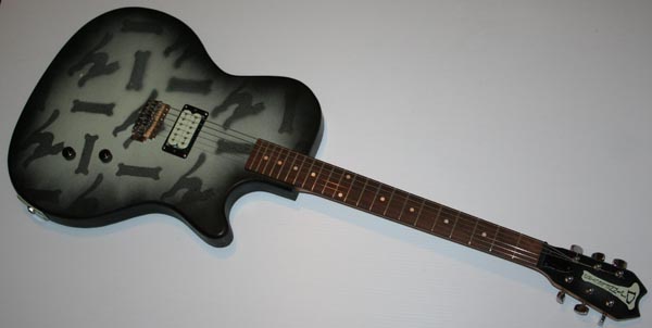

I can't find the pics of the frame glue up but it was 5 pieces of 2x4 WRC with the middle piece running solid till from the butt till right after the bridge.
Sibley, Johnathan - 02/06/2009.04:24:51
specialist in endless variety
Most of the rest is hollow.

Nice job, Johnathan. I like that camo dog-bone theme you've got going there - way cool! I see you went without the lip-stickers on yours, too - how would you rate the sound difference between yours and a "traditional" Dano, just as a ballpark figure? I haven't decided if I'm going to use a humbucker or not, only reason I'm asking that.

Thanks, Jonathan. It's a completely differant animal. An uncovered ceramic humbucker is about as far from a low output single coil in a chrome tube as you can get. I was going more for the economic motivation and aesthetic of a Danno than the sound. One could really rock a street corner with it. You can deffinately hear the hollowness but, it in no way resembles a Danno or a jazz box sonicly. It's realy "hot", I don't think I've ever been able to get it to cleanup totally. Feeds back a lot less than I'd expected. I suspect that if I'd vented the top it would feedback more and have more acoustic volume.
The graphics are black cats and bones, thus the name "the Black Cat Bone", a little nod to Buddy Guy.
Sibley, Johnathan - 02/06/2009.15:35:12
If I remember correctly I knocked the whole thing out in about 4 days. Most of that waiting for glue and paint to dry. The only thing I bought new just for this guitar was the 2x4, all the rest just came out of the junk box. Working cheap can be quite liberating.

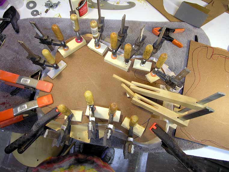

Finally found a shot of the inside before the top went on...
Sibley, Johnathan - 02/16/2009.15:23:47
Correction to post 11, I had to go in through the control cavity and glue a small block in under the bridge.
The build was a whiole ago and all I have to remember this guitar from is the (sparce as they are) build pics and a '60s Alamo amp I swapped for it. The guitar was "stolen" (or I suspect lost) just a couple of months latter. I mean really, there were others they could have taken.
