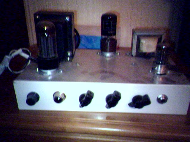

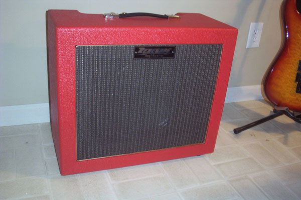

Just took A couple of pics on my camera phone. I sprayed the front of the chassis cream before sarting the amp and i switched the light for purple instead of red, that was very important. I changed the pre amp valve to an old mullard and the power amp valve to a brimar (i think), i stuck with the electro harmonix rectifier that came with it because i couldnt find a suitable vintage repacement, and wasnt that worried about that one anyway. Changing the preamp valve to the mullard made a huge difference but the amp was pretty nice with the electro harmonix and sovteks that it came with. I am in the UK so the kit was supplied with a different power transformer which is why there are taped of wires coming from the side.

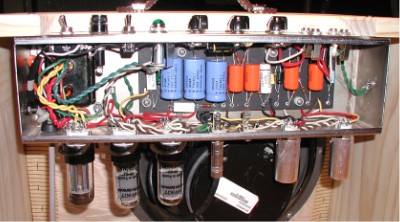

Venables, Wesley - 02/22/2006.15:48:38
Burton-Upon-Trent, UK
The controls are gain (and on switch) tone and master volume.

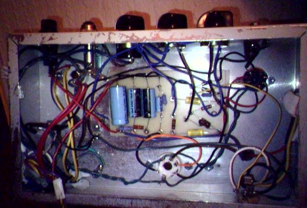

This shows the rats nest inside, my first proper wiring project that wasnt a guitar

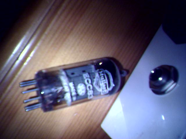

Venables, Wesley - 02/22/2006.15:49:58
my little friend, probably 20 years older than me and still sounding great

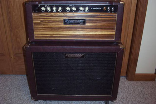

Sure Scott, Here are a few pics, I've got more but these were the fistbatch thatI ran across.
This one is a 60watt Bluesy/CLassic rock 6L6 based amp with Master Vol and Dwell and Mix Reverb. With a Zebrawood panel. The Cabinet has a Celestion Vintage 30 and a Vintage 10 as per customer's request.

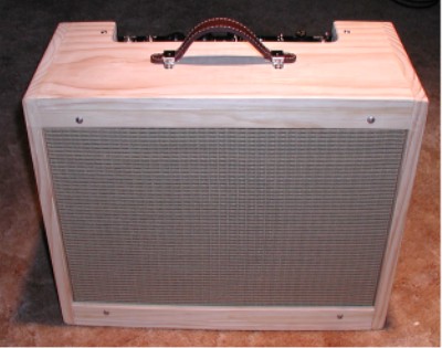

Here's an 18watt that I did for another fellow.

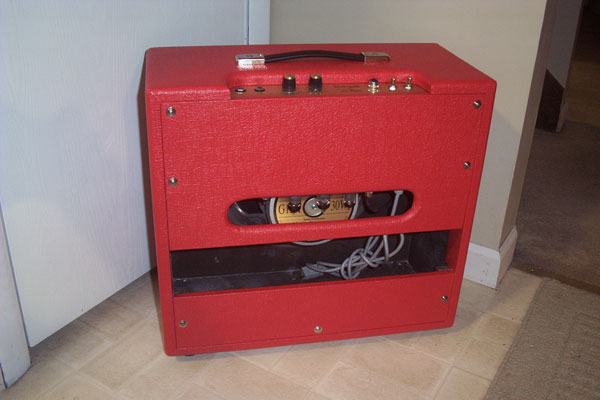

Noel, Nathan - 02/26/2006.00:59:30
The Back...

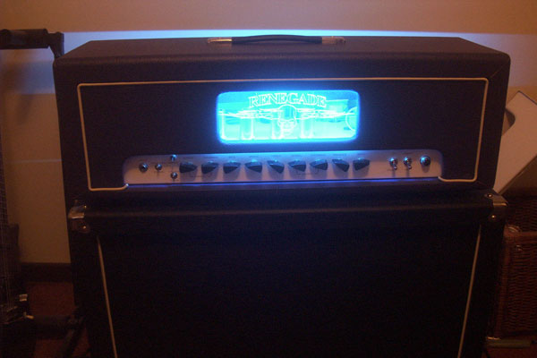

And one more which is a Soldano Clone that I built for myself with a cold cathode backlit Engraved Acrylic name plate.

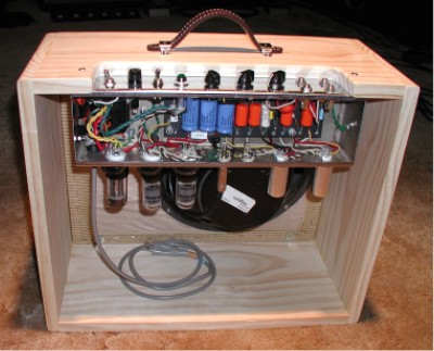

Don't mind if I jump in .. I haven't soldered much more than guitar pots for the last 30 years and decided to tackle a Tweed Deluxe clone. I bought a Torres book about the inside of tube amps and gathered all the parts listed for the project. I stole the output tranny from an old Bogen CHB 50 and had the Eminence 12" hanging on the wall. Everything else came to about 2/3's the price of a kit buying seperate from suppliers and ebay. It took one weekend for the pine cabinet (still waiting for the tweed cloth) and a weekend for the chassis. I've already started collecting parts for another. Holy smokes .. wait .. no smoke, please .. it cranks !! Here are a few pics.
Young, Jim - 03/07/2006.22:01:13
Maker of Fine Exotic Firewood
I need to fit the back panels after I get the tweed on .. and no finger joints because I wasn't sure how it would turn out.
Young, Jim - 03/07/2006.22:04:44
and here is a closer look at the juice box. 12ax7's and 6v6's and a 5y3gt rectifier make up the glass works.

Nathan, that backlit plate is so cool. May I ask where you got it?
Noel, Nathan - 05/03/2006.09:24:59
I made the backlit plate myself. I have a small homemade CNC machine that I engraved it with. A local trophy/awards shop that does laser engraving could do a nice one for you.

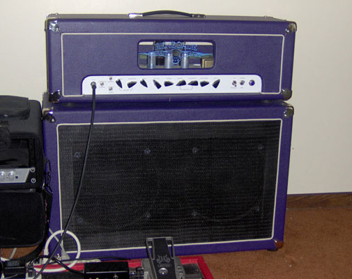

Here's a better picture of the amp... You could not tell that I covered it in purple tolex in the other picture.

Orr, James - 05/03/2006.19:59:36
That's awesome! How did you light it up? It looks like the light is coming from the sides? I wonder how fine the engravers can get? I have an illustration with a lot of detail that I'd love to try a more appropriate version of.
Noel, Nathan - 05/04/2006.14:11:27
I use a single cold cathode flourescent tube mounted above the plate. Half of the tube is taped because the full light of the tube is a bit too intense. The tube is the same kind that computer case modders use to light up the inside of their computer. I used a separate 6.3v-0v-6.3v Transformer; Then rectified and regulated that voltage to 12VDC and power the Cold Cathode from that.
It might be possible to do an engraving of the raster image that you posted with a laser to produce a half-tone style engraving. A rotary engraver like I used can't do half-tone images without a great deal of difficulty but lasers can make quick work of raster images. Line art makes more dramatic illuminated signs though.
