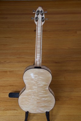

This one has been taking up space in my shop for ages, and I finally finished it today. This arguably belongs in "other stringed instruments," but it's really just a little 4-string archtop guitar, so I'm posting it here.
Top is sitka spruce
Back & sides are quilted maple
Ebony fretboard, headstock veneer and bridge
Cocobolo finger rest

Thanks. Brian, I think it has a nice, rounded woody sort of sound with the nylon strings. The highs are a little muted compared to a standard ukulele, as you'd expect. It sounds better plucked than strummed. Yes, it has a high G string. I might change that later. No neck reinforcement or bracing on this one - I really don't think it needs it.

Very nice, love the maple! Is the top x-braced or?
John Clifford
Posts: 180
Re: Archtop Tenor Uke
Post by John Clifford »
