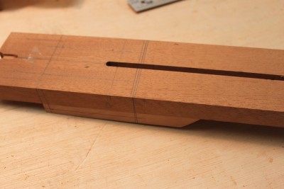

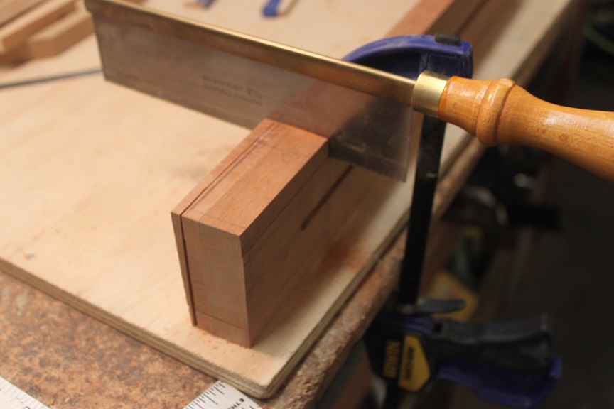

OK, Randolph, I am home and I got out the ALS plans. I built my first 335 to them, then decided to change some things on my second. The ALS plans call out a 2 degree neck angle and show no overstand. Measuring the distance from the top of the binding to the top of the center of the top on the side view gives the arching at 1/8 inch. Interestingly, they also show the height of the binding as 1/8 rather than the usual 1/4. They show a ToM bridge that appears to be sitting on the top of the guitar (ie at its very lowest adjustment). The Nashville style bridge that I use is about 5/8 at its lowest setting.
Anyway, I did initially set the neck at the 2 degrees which seems to have worked with the arching in my top
In that last picture the bridge is sitting on little pieces of wood that are the same thickness as the tops of the studs. What I am looking for at that point of construction (since the board isn't fretted yet) is that the end of the straightedge be twenty or so thousands below the tops of the saddles. When fretted I like it to just hit the tops.
Its interesting that when I built the second one with plates from the same source that I have a photo showing the neck pocket jig and my protractor sitting next to it. The protractor reads 3.3 degrees which is very close to a Les Paul. However that guitar did use a roller style ToM and probably was taller.
Bottom line, lay out YOUR neck geometry with both the top and bridge that you plan to use. Decide what range of adjustment you feel is necessary to get the action you like. Hope this helps.
