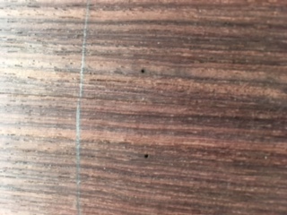

Hi! I just discovered some annoying worm holes in two sets of Indian rosewood, and I wonder if that happened in my shop or before. I live in south Maine, and never had this problem before. I thought I didn't have to worry about, but now I am
Do you guys take special precautions regarding insects attacking our precious wood?

I’ve seen it a few times in rosewood I’ve purchased. Rosewood is very forgiving for this type of thing. If you sand around it to pack some dust in the hole and put a drop of CA glue on it, you’ll have a hard time finding it again after you sand the repair.
If you think that it actually happened in your shop, you might want to put the wood in the oven at 200F for a few minutes to kill the bugs. Since the holes are pretty round, like the blade sliced through a tunnel when the wood was resawn, a bug in your shop isn’t very likely unless you did the resawing.

I think the holes might have been there when I've got the wood, cause the holes are symmetric, as a result of split it when re sawing, as you suggested.Bob Gramann wrote:I’ve seen it a few times in rosewood I’ve purchased. Rosewood is very forgiving for this type of thing. If you sand around it to pack some dust in the hole and put a drop of CA glue on it, you’ll have a hard time finding it again after you sand the repair.
Sorry, I panicked thinking all my wood was at risk. Thanks for the tip how to fix it. I have done it in ebony. It should be straight forward.
Thanks.

Seriously, I have a small stack of wood in south Spain, and last time I went for vacations I found a cocobolo set full of worms holes. So I'd say its a real concern at least in warm weather areas.

Anyway, I took a close look at this plank a couple of days ago and was a little dismayed to see some tiny worm-holes here and there. I'm thinking they shouldn't be hard to fill with some ebony dust.
Some friends and I lost an entire stack of white oak to what we believe were powder-post beetles. We got it green, slathered the ends with anchor-seal, stickered and stacked them and left them to dry for about five years (these were thick planks - 8 and 12/4) but neglected to wash them down with a borax solution. If only the beetles had been considerate enough to have bored somewhat uniformly...

I knew a fellow who lost a large pile of maple double bass backs to worm damage. Somehow they got stacked up on a dirt floor in a pretty tight pile, and by the time he looked at them there was not a piece big enough for a violin left without a worm hole.
