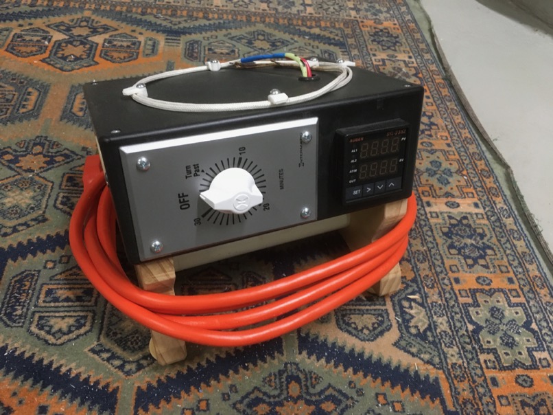

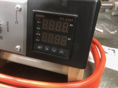

I prefer to make my own jigs/tools using the newest technology. So I put this together a few years ago with Fred Tellier's help over on the OLF. The temperature controller is from eBay for about $30. It uses a K-type thermocouple that you insert into the sandwich. Set the temperature you want and just sit back. I love it and have much better bending results than when I just used a dimmer switch.

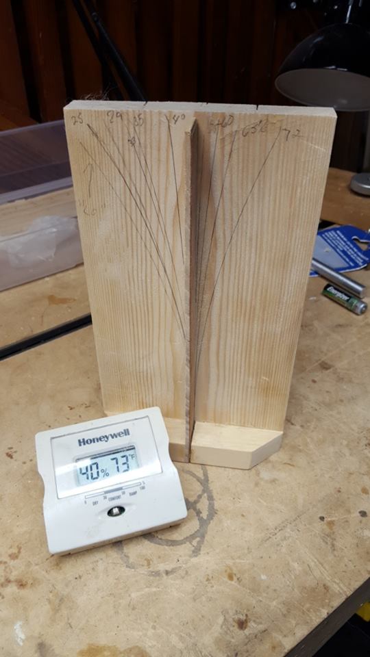

Stephen, I still do it with the Mark I brain and eyes, and use a kitchen oven thermometer with a cabled probe, costing about $10-15. It has over/under temperature alarms, and has sufficient precision for this application. I also use it to check the relative humidity, by first noting the room temp, and then wrapping the probe with a wet cloth sock, and then placing it in front of an open dust collection port (the d/c running of course ;)). I note the temperature when it's stable, and then consult published sling psychrometry tables to determine the RH from the difference between the dry & wet readings.
But I still look at my visually practical shopbuilt RH indicator, It has a long time constant for its response to RH changes, rather than a momentary measurement of ambient RH
