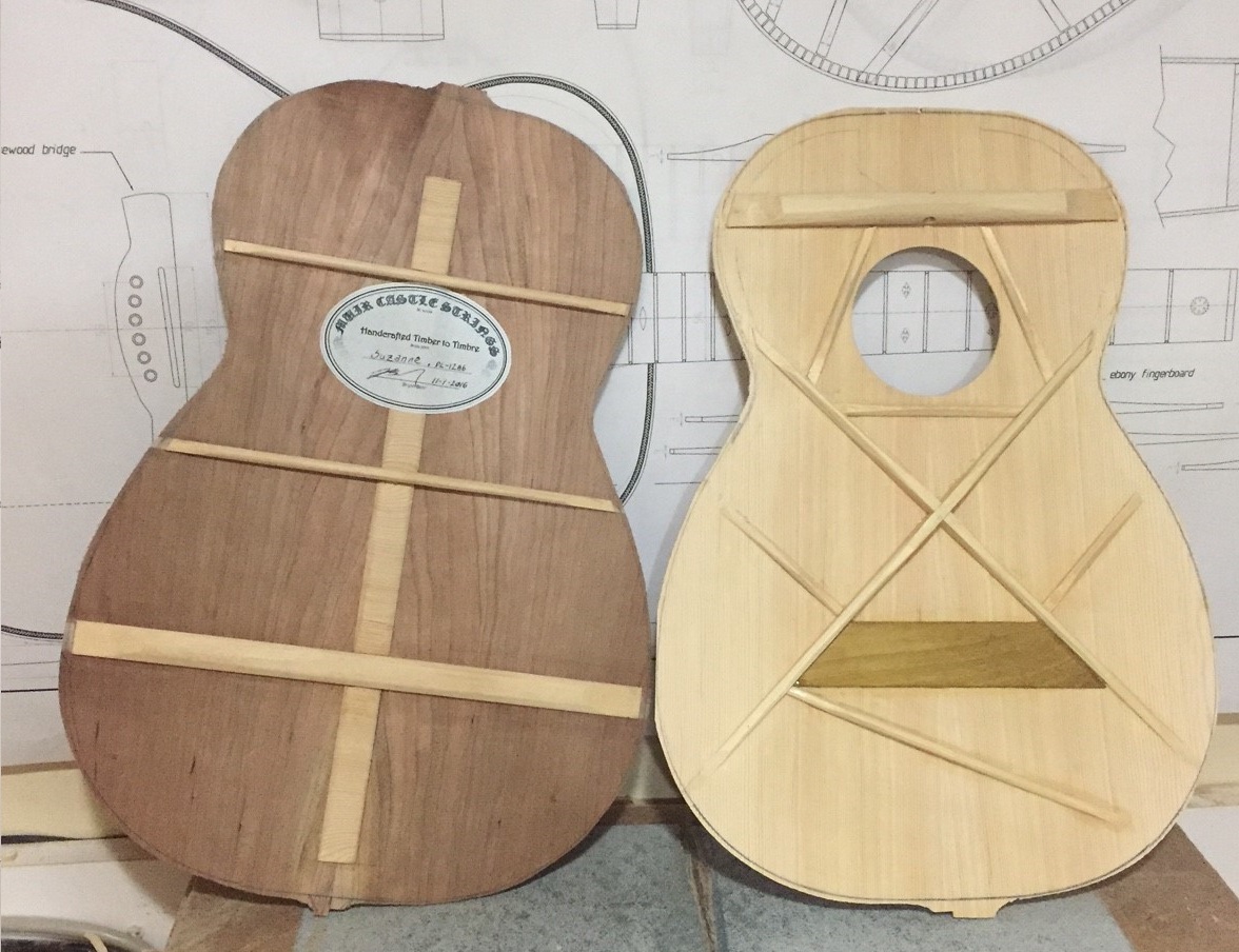

Noted for the next one. This top still has 10 mm of over hang from the outline, then 2mm of ribs and 7 or 8 mm of liner. By the time all this is done the brace ends will be very close to the liner and I will secure somehow, maybe a pillar running up the side sitting on the brace end.Alan Carruth wrote:I've inlet X braces into the upper transverse brace in the past. I would not leave those upper ends floating: too much of a chance of them peeling up, particularly if the top takes a knock.

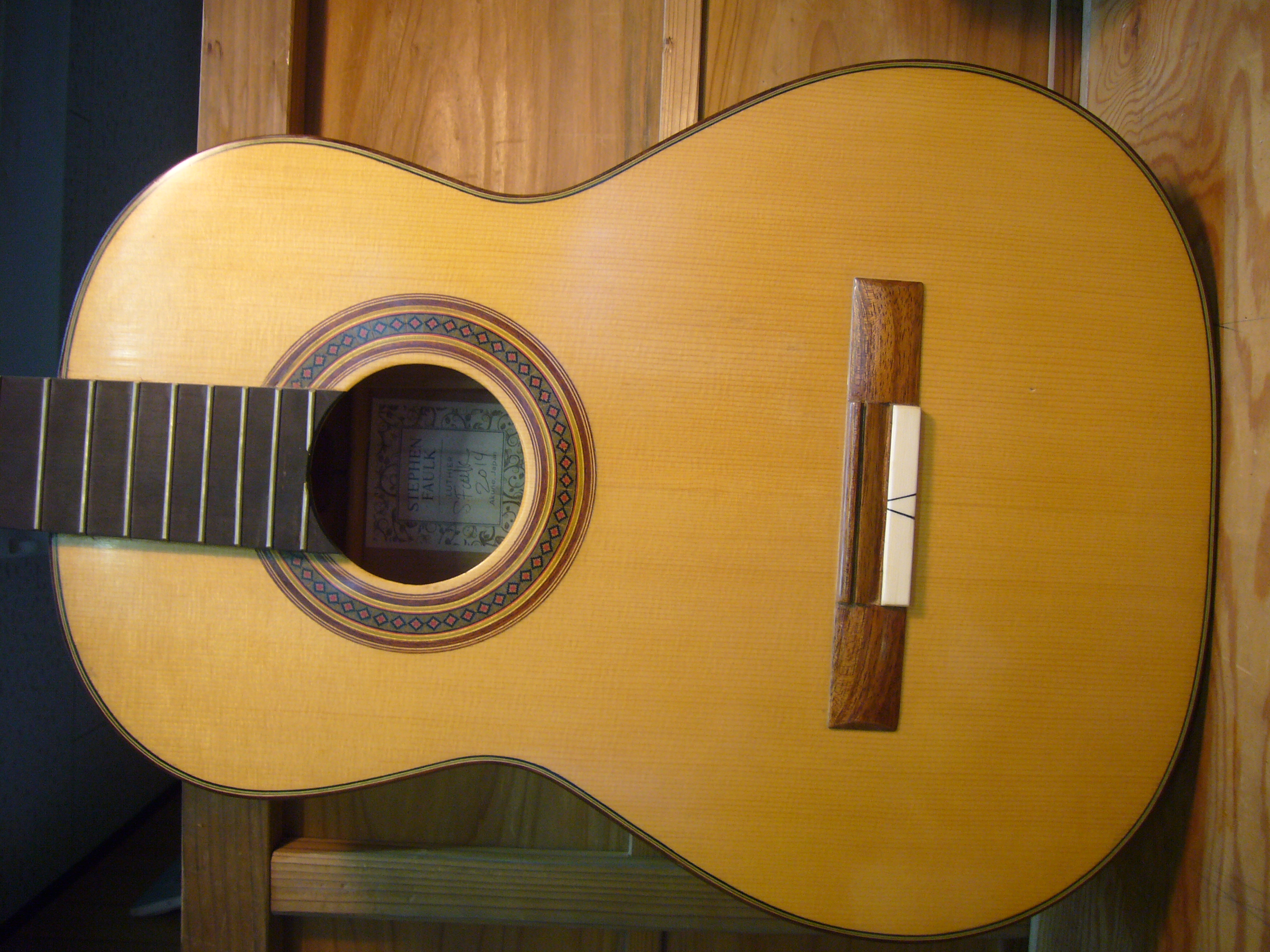

Good idea. The narrow lower but classical is 13" wide in the lower bout. The photo does not really show the proportion well. I have been toting with the idea of just making SS with my regular flamenco plantilla which is a Santos derived outline. And I have a 19th century Torres size I have made as a classical that would be nice. I think I am going to have change some of what I am doing and make SS half the time, folks around here just shrug their shoulders over nylon guitars. The repair work I get is all steel string also. 90% of my work is export and it's getting tiring to buy boxes and do all mailing and worrying.
I've been making nice compound curve cutaways and I think those might be sexy as SS. Thats' why I'm making this off handed small one, I have the material laying around and the stake are not high. I've already learned you must make those brace ends tuck under something!
This is the Torres-ish plantilla I make another small classical on. I think i could be a SS

I post this picture not as advice but because it may spur the discussion on x bracing these little guys. I have not finished this guitar so I have no idea what it will sound like. The bracing was as much intuition as anything else so I make no claims that it is a good way to go. This body is bigger than yours but I had to make the same types of descisions, how wide to make the X and still hit the bridge, tone bar behind the X. . . I ended up widening the splay of the X as much as I could which meant I had to tuck the upper ends right at the waist.
Body length 18 1/4", lower bout 12 3/4", 12 fret 24.9" scale.
