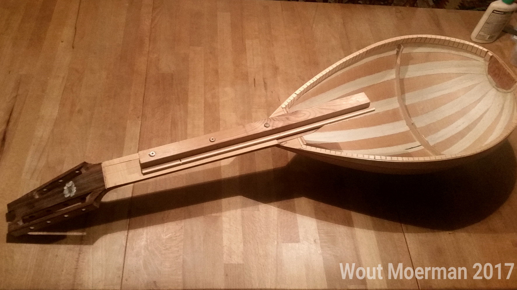

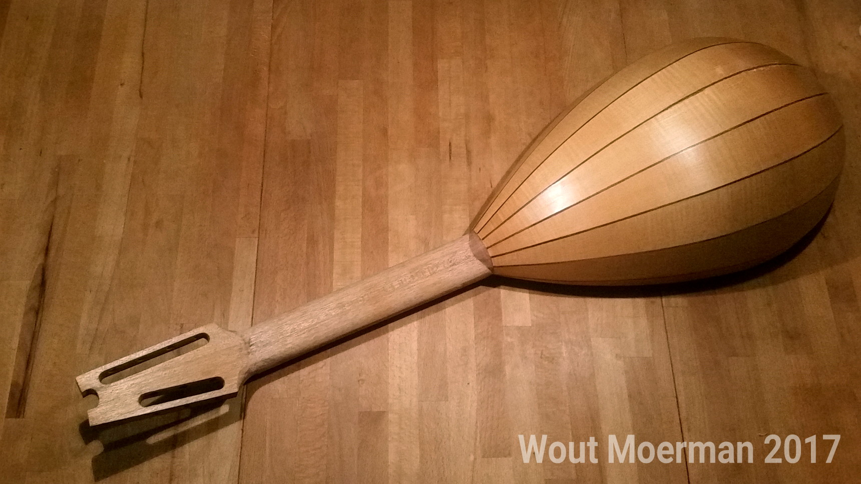

Here are two pics of the lute guitar. The block of wood attached to the neck is to secure it in the vice.
Re: Bracing suggestions for experimental lute guitar
I wonder how it would sound if you glued in a flat "inner back" to give it more of the characteristics of a guitar body? You might want to give it a sound port to allow it to move more freely between the curved "outer back" and the soundboard.
Wout Moerman
Posts: 17
Joined: Thu Jan 05, 2017 5:28 pm
Post by Wout Moerman »
Interesting idea, but I think I value the internal volume more than a internal soundboard.
