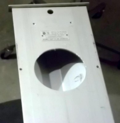

The only change to the body was a hole cut to hold the resonator.

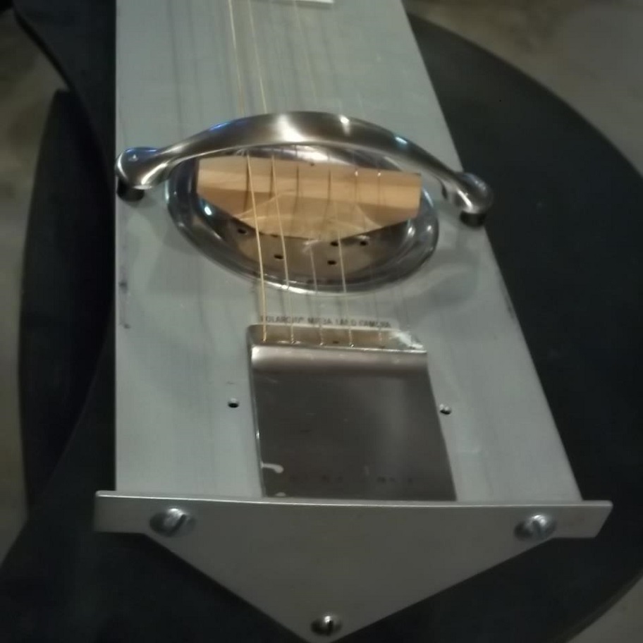

The resonator parts are a small pet dish and the spider is a steel plate with a dogwood saddle.
The assembled resonator is held together by a screw which also "loads the cone". The tailpiece was bent from a scrap piece of stainless steel. The handrest is a large drawer pull.

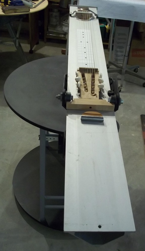

The peghead was reclaimed from the scrap wood box. it was a first attempt to cut a slotted peghead only partially through & all the mistakes were retained. The nut is a very hard piece of Mesquite that was intended for cooking.

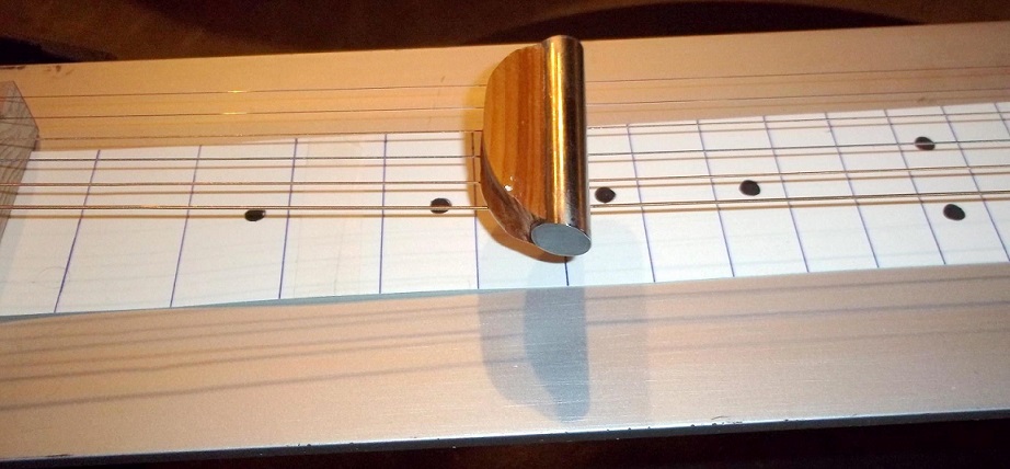

You need a Steel to play it. This one was a 5/8" stainless steel bolt & a scrap of Deodar Cedar. The fret board is heavy paper & ink. The strings were reclaimed from string changes.

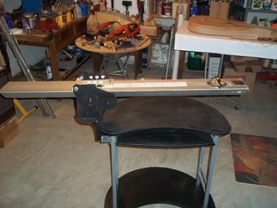

This is the completed entry in the challenge. The 4' 8" hollow , triangular body was once the upright part of a Polaroid MP 3A Land Camera.

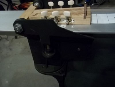

The black part is the former camera holder, it now holds the Didgeridoo-Bro, provides a pivot and a easily changeable scale length. the base is a former computer table. Like everything in my shop it has wheels.
