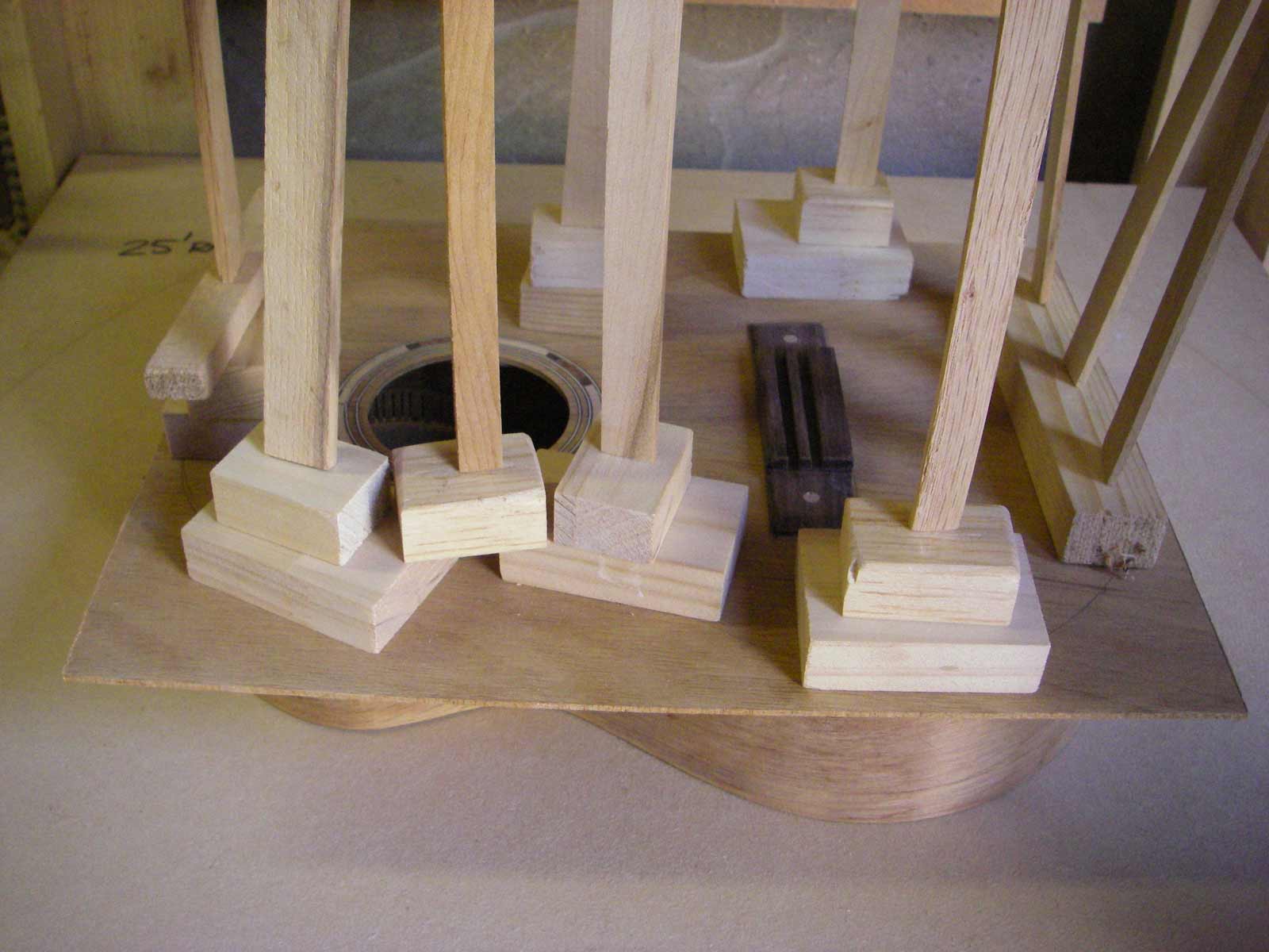

Postby Patrick DeGreve » Fri May 03, 2013 12:22 pm
On the guitars I have made I have always glued the bridge on after I glued on the fretboard. On the uke I felt I must glue the bridge on before I glue the soundboard to the sides because the soundhole is so small I don't think I could get a clamp in there to glue it on. I will have to be very carefull when I glue on the fretboard to make sure the scale length is right.

Postby Patrick DeGreve » Fri May 03, 2013 12:48 pm
I drilled two holes through the bridge, soundboard, and bridge brace and then glued in two dowells. I like the look, and think it gives a little more stability to a classical bridge.

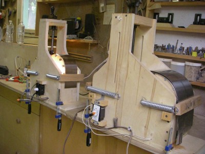

Postby Patrick DeGreve » Mon May 06, 2013 2:02 pm
I next glued the back to the sides and let it set overnight. While it was drying I bent the bindings for both the projects using both the small fox bender and the full size fox bender. I am using binding I bought in bulk on Ebay. The uke binding is maple with black-red-black.

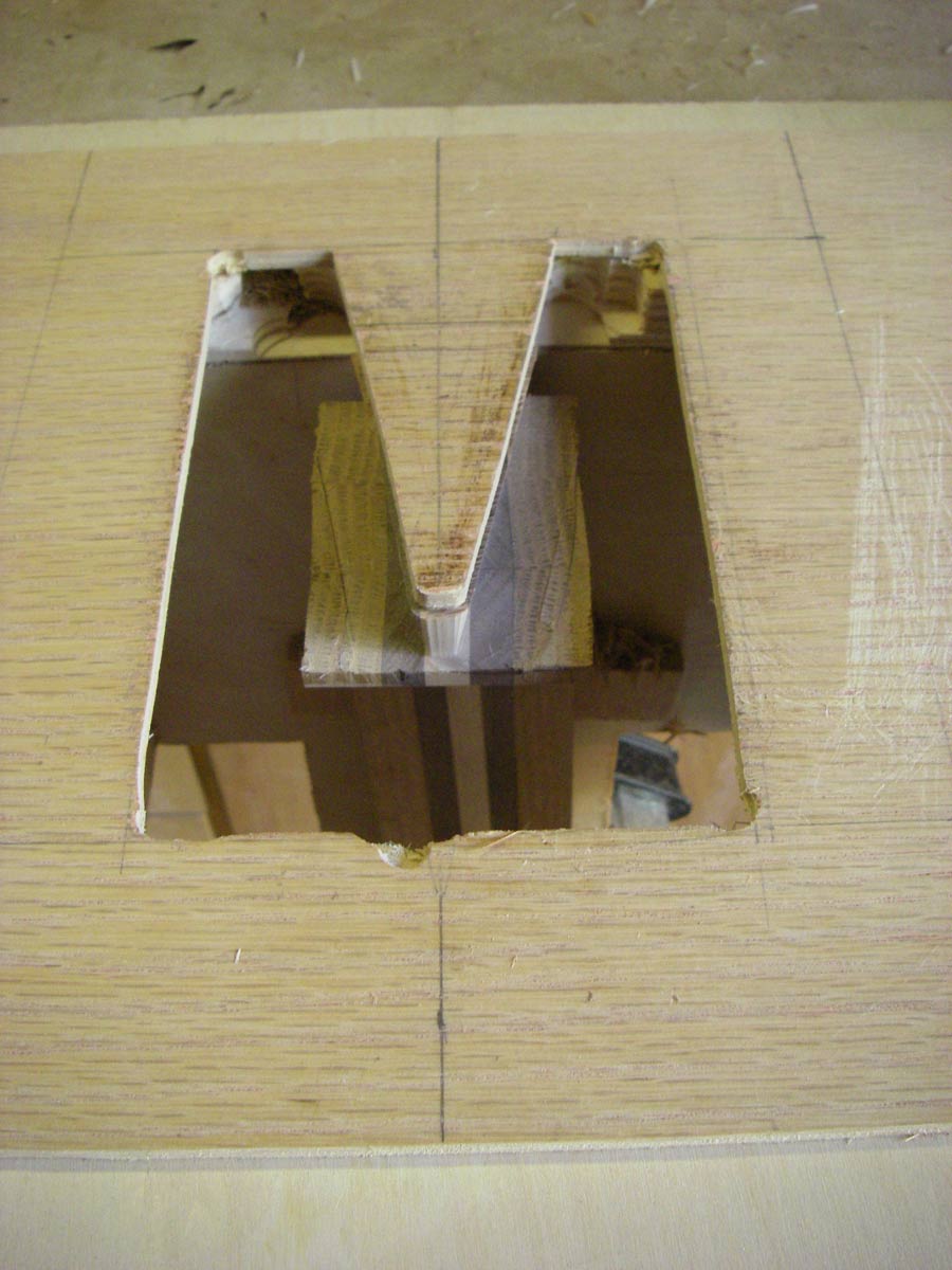

Postby Patrick DeGreve » Fri May 24, 2013 1:03 pm
I routed the dovetail mortise in the plywood jig.

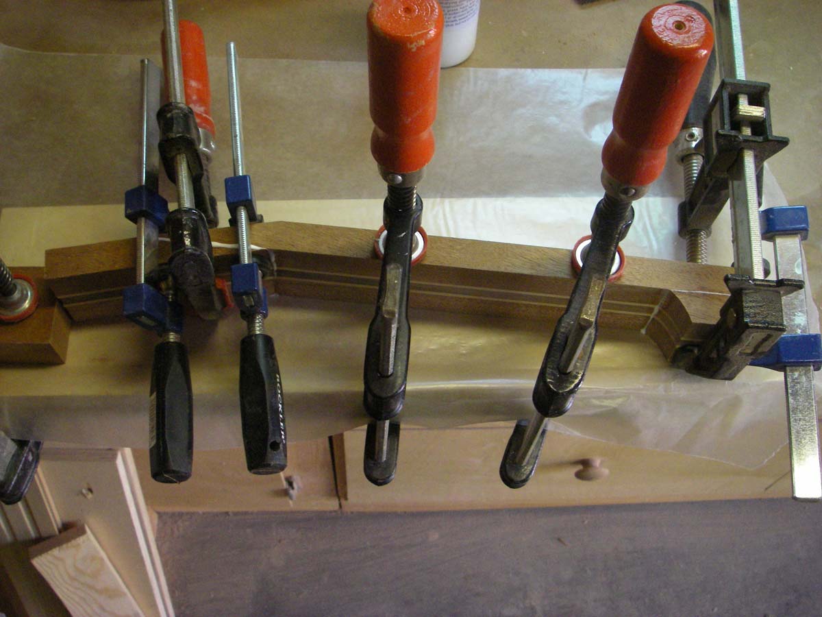

Postby Patrick DeGreve » Fri May 24, 2013 1:06 pm
I have now glued up the neck scarf joint and the heel.

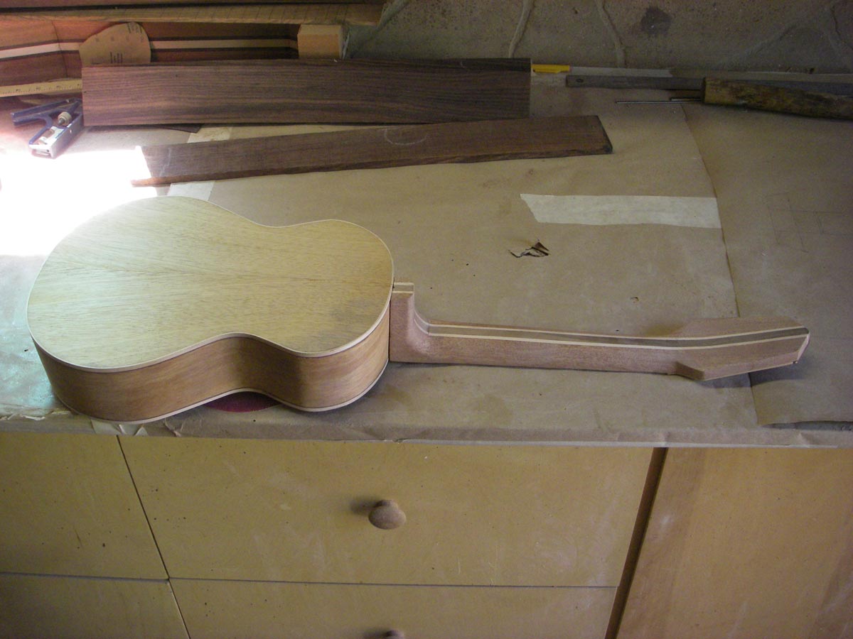

Postby Patrick DeGreve » Fri May 24, 2013 1:19 pm
Here is a shot of the uke with the neck set in place, and the fretboard taped on.
